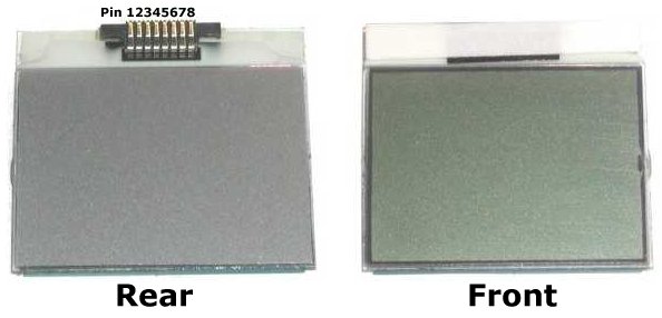

Attached is an include file for the Nokia 3310 LCD that has been modified from Gusse's code (in this thread Post 93 in the thread http://www.picbasic.co.uk/forum/show...0209#post70209 ), adds Darrel's PrintStr function, and a modified form of it for printing variables.
Using this include makes it much easier to use this LCD.
Here is an example of writing different text on separate lines:
@ PrintStr 0,0, "I love being" @ PrintStr 0,1, "able to print " @ PrintStr 0,2, "so easily!"
Ok, the printing a variable solution:
PosX = 0 'position 0 of 84 in the x direction PosY = 0 'row 0 (of 0-5) gosub Lcd_GotoXY Lcd_Data = (result dig 3) + 48 gosub Lcd_SendChar PosX = 6 'position 6 of 84 in the x direction PosY = 0 'row 0 (of 0-5) gosub Lcd_GotoXY Lcd_Data = (result dig 2)+ 48 gosub Lcd_SendChar PosX = 12 'position 12 of 84 in the x direction PosY = 0 'row 0 (of 0-5) gosub Lcd_GotoXY Lcd_Data = (result dig 1) + 48 gosub Lcd_SendChar PosX = 18 'position 18 of 84 in the x direction PosY = 0 'row 0 (of 0-5) gosub Lcd_GotoXY Lcd_Data = (result dig 0) + 48 gosub Lcd_SendChar
This makes it a lot easier with a one liner:
@ PrintVar x,y, _anyvariablehere
@ PrintStr 0,0, "If I write more than one line, it will scroll to the next one, and next."
