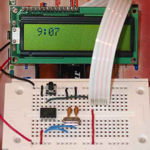

Attached are two programs that demonstrate how to easily make accurate clocks WITHOUT the use of Interrupts or Real Time Clock (RTC) chips. Both are based on TMRO but do not require preloading, adjusting, or tweaking the TMRO register before or after overflows. These programs also give the user lots of time to do other stuff between clock updates. The only time error is 100% related to crystal tolerance and drift (these examples require a 4 MHz crystal). The programs are based on the PIC12F629 but can be changed to your controller of choice. Extensive comments and schematics are in the code.
These programs maintain the time as accurately as a DS1307 RTC or similar at +/-2 sec/day. If you need super accuracy, I suggest a MAXIM DS3231 RTC which boasts +/- 1 min/year accuracy.

Program 1 : EZCLOCK1.bas
A simple program to set and show the time on an alphanumeric serial LCD (HH:MM format with blinking colon). Most of the code is dedicated to setting the initial time. Only about 30 lines of the code are required to accurately maintain the time and LCD updates, including colon blink.
