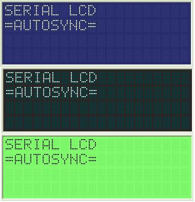

    I like to use the Oshonsoft PIC simulator to get really professional looking results.
