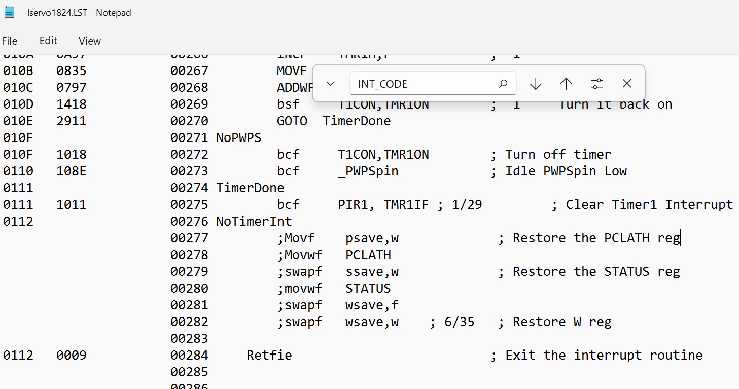

    What those two chips have in common is auto context save for interrupts.
    i simulated the 1824 and the problem was not experienced, but who would trust a simulator
    try this for 12f1840/16f1824 removing bogus context save/restore code
    '****************************************************************'*  Name    : PWPS_Servo.INC     Pulse Width Position Servo     *
    '*  Author  : Darrel Taylor                                     *
    '*  Date    : 5/1/2003                                          *
    DEFINE INTHAND INT_CODE                 ' Tell PBP Where the code starts on an interrupt
    ;wsave       VAR BYTE    $20     SYSTEM          '$20 Save location for the W register if in bank0
    ;wsave1      VAR BYTE    $A0     SYSTEM          ' Save location for the W register if in bank1
    ;wsave2      VAR BYTE    $120    SYSTEM          ' Save location for the W register if in bank2
    ;wsave3      VAR BYTE    $1A0    SYSTEM          ' Save location for the W register if in bank3
    ;ssave       VAR BYTE    Bank0   SYSTEM          ' Save location for the STATUS register
    ;psave       VAR BYTE    Bank0   SYSTEM          ' Save location for the PCLATH register
    W1                  var word                    ' Temporary variable
    y                   var byte                    ' Temporary variable
    PulseTicks1ms       var word                    ' # of Ticks for 1ms
    TicksPeruSx100      var word                    ' # of Timer Ticks to = 1 us * 100
    uS50Hz              var word                    ' # of Ticks for 50 Hz with prescaler
    PicOSC              var byte Bank0              ' OSC value, Usable in PBP
    OffTimePrescaler    var byte                    ' Timer1 Prescale value during OFF period
    Position            var word          ' 0 - 900   0 = 1.05ms   900 = 1.95ms
    T1CONoff            var byte Bank0
    TMR1_ON_TICKS       var word          ' # of Tmr ticks for On Time
    TMR1_OFF_TICKS      var word          ' # of Tmr ticks for Off Time
    TMR1_ON_VAL         var word Bank0    ' # to load TMR1 for On Time
    TMR1_OFF_VAL        var word Bank0    ' # to load TMR1 for Off Time
    DataFlags           var byte Bank0
    Valid               var DataFlags.0   ' 1 if Freq is valid - Set by CalcPWPS:
    PWPSenabled         var DataFlags.1   ' shows if PWPS is running or not
    PWPSstate           var DataFlags.2   ' Current state of PWPS output high or low
    GIE                 var INTCON.7
    PEIE                var INTCON.6
    TMR1IE              var PIE1.0
    TMR1ON              var T1CON.0
    goto GetOsc
    asm
    INT_CODE
          ;if (CODE_SIZE <= 2)
          ;  movwf   wsave              ; copy W to wsave register
          ;  swapf   STATUS,W           ; swap status reg to be saved into W
          ;  clrf    STATUS             ; change to bank 0 regardless of current bank
          ;  movwf   ssave              ; save status reg to a bank 0 register
          ;  movf    PCLATH,w           ; move PCLATH reg to be saved into W reg
          ;  movwf   psave       ;6     ; save PCLATH reg to a bank 0 register
          ;endif
            btfss   PIR1, TMR1IF       ; is TMR1IF set?   Timer1 Interrupt Flag
            GOTO  NoTimerInt           ; No.  Bypass timer load
            btfss   _Valid             ; Is Freq valid?
            GOTO  NoPWPS               ; No.  Halt PWPS
            btfss   _PWPSenabled       ; is Software PWM enabled?
                                       ; Yes, then Set output and reload Timer1
            btfss   _PWPSstate         ; Is Output High?
            GOTO  TurnON      ;9/15    ; No.
    TurnOFF
            bcf     _PWPSpin            ; Set PWPSpin Low
            bcf     _PWPSstate          ;
            MOVF    _T1CONoff,W         ;    Load OFF Period Prescaler and Turn off timer
            MOVWF   T1CON               ;
            MOVF    _TMR1_OFF_VAL,W     ;  1
            ADDWF   TMR1L,F             ;  1    reload timer with Off Period value
            BTFSC   STATUS,C            ;  1/2
            INCF    TMR1H,F             ;  1
            MOVF    _TMR1_OFF_VAL+1,W   ;  1
            ADDWF   TMR1H,F             ;  1
            BSF     T1CON,TMR1ON        ;  1    Turn it back on
            GOTO  TimerDone   ;13/28
    TurnON
            bsf     _PWPSpin            ; Set PWPSpin High
            bsf     _PWPSstate          ;
            CLRF    T1CON               ;    Clear Prescaler and Turn off timer
            MOVF    _TMR1_ON_VAL,W      ;  1
            ADDWF   TMR1L,F             ;  1    reload timer with On Period value
            INCF    TMR1H,F             ;  1
            MOVF    _TMR1_ON_VAL+1,W    ;  1
            ADDWF   TMR1H,F             ;  1
            bsf     T1CON,TMR1ON        ;  1     Turn it back on
            GOTO  TimerDone
    NoPWPS
            bcf     T1CON,TMR1ON        ; Turn off timer
            bcf     _PWPSpin            ; Idle PWPSpin Low
    TimerDone
            bcf     PIR1, TMR1IF ; 1/29         ; Clear Timer1 Interrupt Flag
    NoTimerInt
            ;Movf    psave,w             ; Restore the PCLATH reg
            ;Movwf   PCLATH
            ;swapf   ssave,w             ; Restore the STATUS reg
            ;movwf   STATUS
            ;swapf   wsave,f
            ;swapf   wsave,w    ; 6/35   ; Restore W reg

    how sure are you that your code is compiled with the modified inc as i suggested ?
    if you examine the lst file generated and search for NoTimerInt
    do you see
    Name:  Screenshot 2022-07-06 104811.jpg
    pbp can be tricky if multiple versions of inc files exist, sometimes the "wrong" version can be used inadvertently

    100% sure, here is my LST file:
    Servo_Mod_INC.LST.txt
