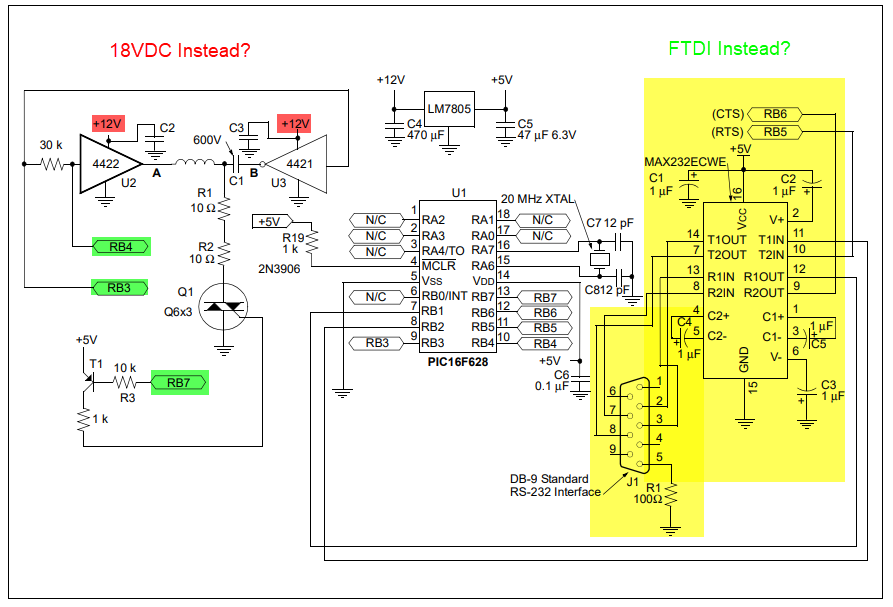

    This might make things easier:-)

    Default Re: UnderWater Antenna 125KHz Driver using a 16F628 @20MHz Example Code
    Hi Jay.
    I am not sure what RB3, RB4 and RB7 are used for. I guess the RB3 is the PWM signal output, but the rest?
    As I understand it, you just want a 50% square signal at 125KHz?
    Ioannis,
    I have the beast generating 125KHz from the hardware module quite nicely.
    To modulate a data stream, I am simply changing
    TRISB.3 from an Output to an Input.

    3,807
    So, you are generating the 125KHz 50% duty cycle signal?
