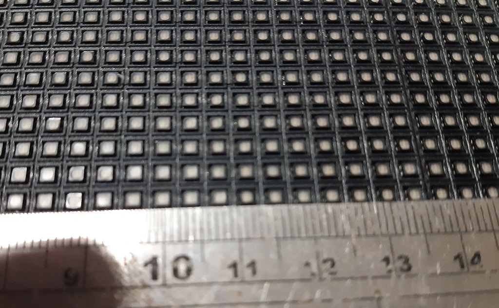

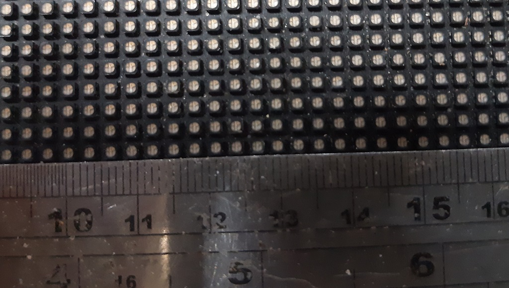

    it would be difficult to pack rgb leds more tightly than these
    p3 64x64 p4 32x64 modules

    and they work, limited to 8 colours with pbp

    Yes, bottom ones are 3030 leds. And they're placed sparsely.
    Now check footprint of 1206 or 0805 enclosure and compare sizes
