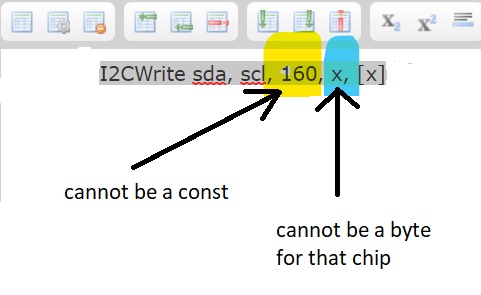

    you need to do it properly

    2,682
    Default Re: Another attempt for I2C eeprom, this time - 25C256.
    it a constant , pbp constants are 16 bits , i2c address are 8 bit
    use your logic analyzer

    2,682
    Address var byte
    Address = 160

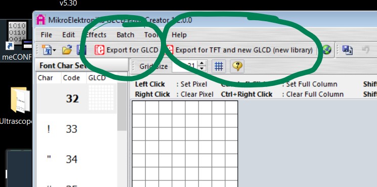

    The issue with Mikroe "creation" is it, as everything else done by them, is written with left feet- need admin priviledges to run it, and
    make an icon and assign admin to it , not a problem. running in compatibility mode can help if it wont save stuff w10 is ok without it
    it outputs fonts rotated by 90 degrees
    glcd mode is data by column, tft mode is data by row , there is no problem
    I don't see any mode selector in GLCD font creator from their website.
    2,682
    don't think you looked too hard

    Feb 2013
    1,154
    Thanks a lot !
    At my system, that menu bar was not visible at all
    and in file/edit menu, they have no such setting...
