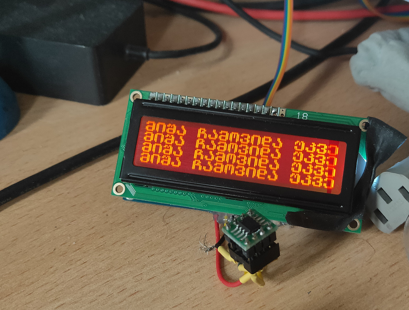

    Currently I'm doing this in the following way:
    FOR X=0 TO 17 step 2	'READ ARRAY INTO VARIABLE, ARRAY MEMBER CHAR=EEPROM OFFSET
    Y=topline[x]
    Z=topline[x+1] 'READ  INTO VARIABLE AS TWINS
    FOR I=0 TO 7	'HELPER LOOP FOR CHARACTER READING
    READ Y+I,A 'READ EEPROM BYTES INTO VAR
    READ Z+I,B
    LCDOUT $FE,$80+i+c 'UPDATE Y POSITION
    LCDOUT $FE,$80+x/2 'UPDATE X POSITION
    if y=255 then a=0
    if z=255 then b=0 'blanker for space display
    LCDOUT a
    LCDOUT b 'WRITE TO SCREEN
    NEXT I
    NEXT X
    C=number of line*8 where text had to be displayed.

    Oh and I'll ask here. Is it possible to do bitwise shift between array members?
    I'm adding some smooth scroll options to that display, and vertical scrolling is easy, since 1 byte = 1 vertical line of pixels. But for horizontal scrolling, 1 byte = 8 horizontal pixels, so scrolling is not that smooth. I remember, I was doing this on ZX Spectrum In Assembler, but forgot how
