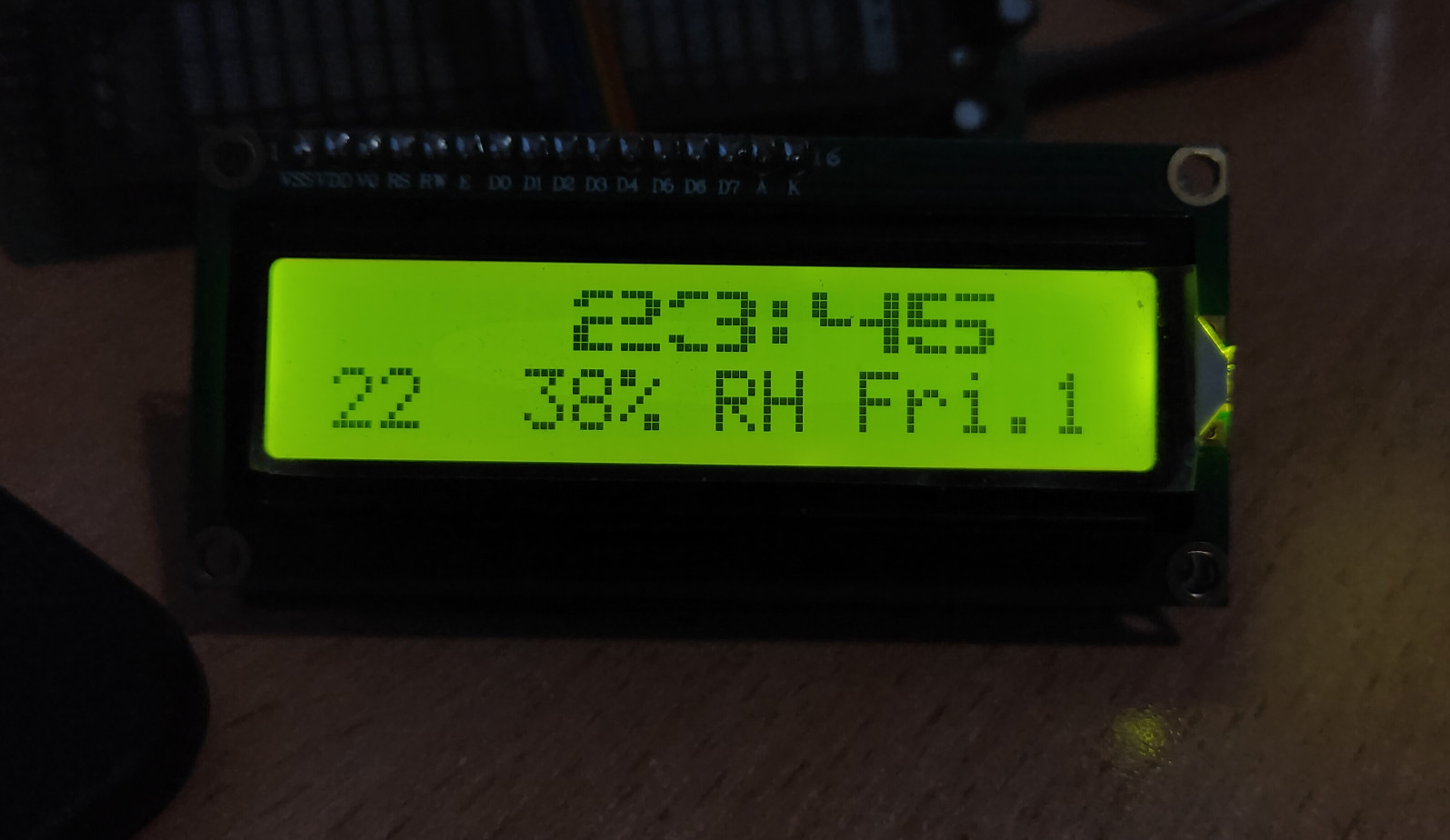

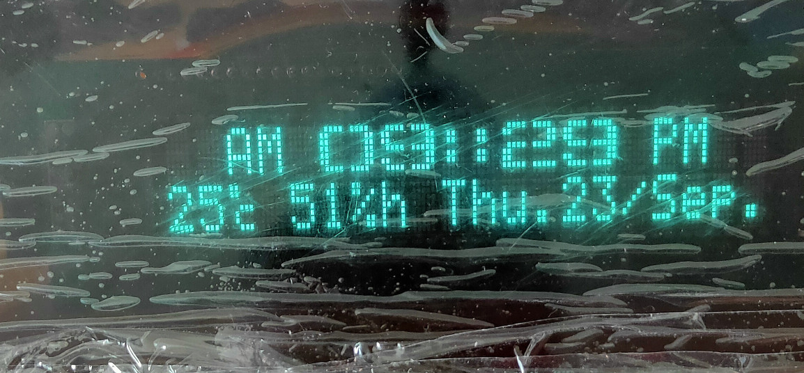

    Hello.
    Below is my code which generates very nice looking, double width letters from 0 to 9, on any HD44780 compatible LCD module. Works well on LCD, OLED, VFD. Below I'm attaching the sample pictures.
    Default Re: Code for double width characters on any HD44780 compatible display, need EEPROM i
    A cold LCD can't update smoothly at 25fps in fact 5fps would be a challenge.
    Can you store the static LCD data in the PIC program flash memory using EXT instead of the eeprom.
    http://dt.picbasic.co.uk/CODEX/TheEXTExternalModifier
    Feb 2013
    1,160
    Average 1602 LCD can do 20 FPS. Black on green (or white) are generally faster than white on blue. About 2-3 times faster. VATN LCD are even faster, but having same price as OLED, I see no point of using them.
    OLED and VFD can do 60-100 FPS.
    All tested with PBP. This is not an issue.
