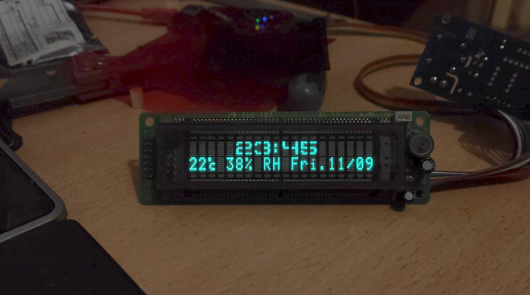

    I had a Noritake VFD module lying around, and decided to make a clock out of it.
    Since it is HD47780 compatible, there were no issues for main display code, as you can see from the attached picture.

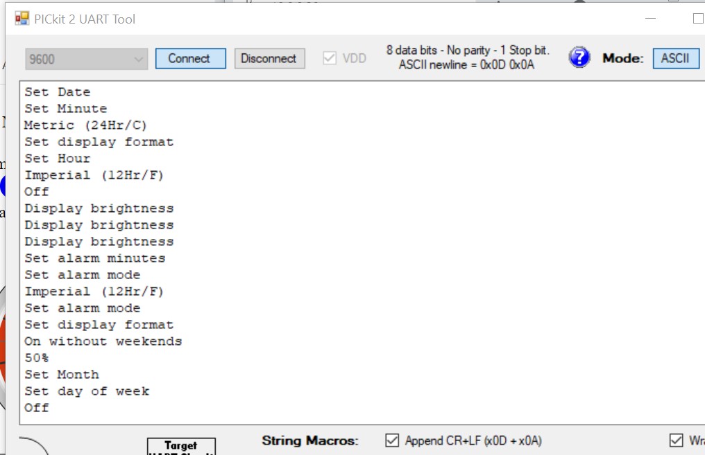

    Name:  Screenshot 2021-09-13 141521.jpg

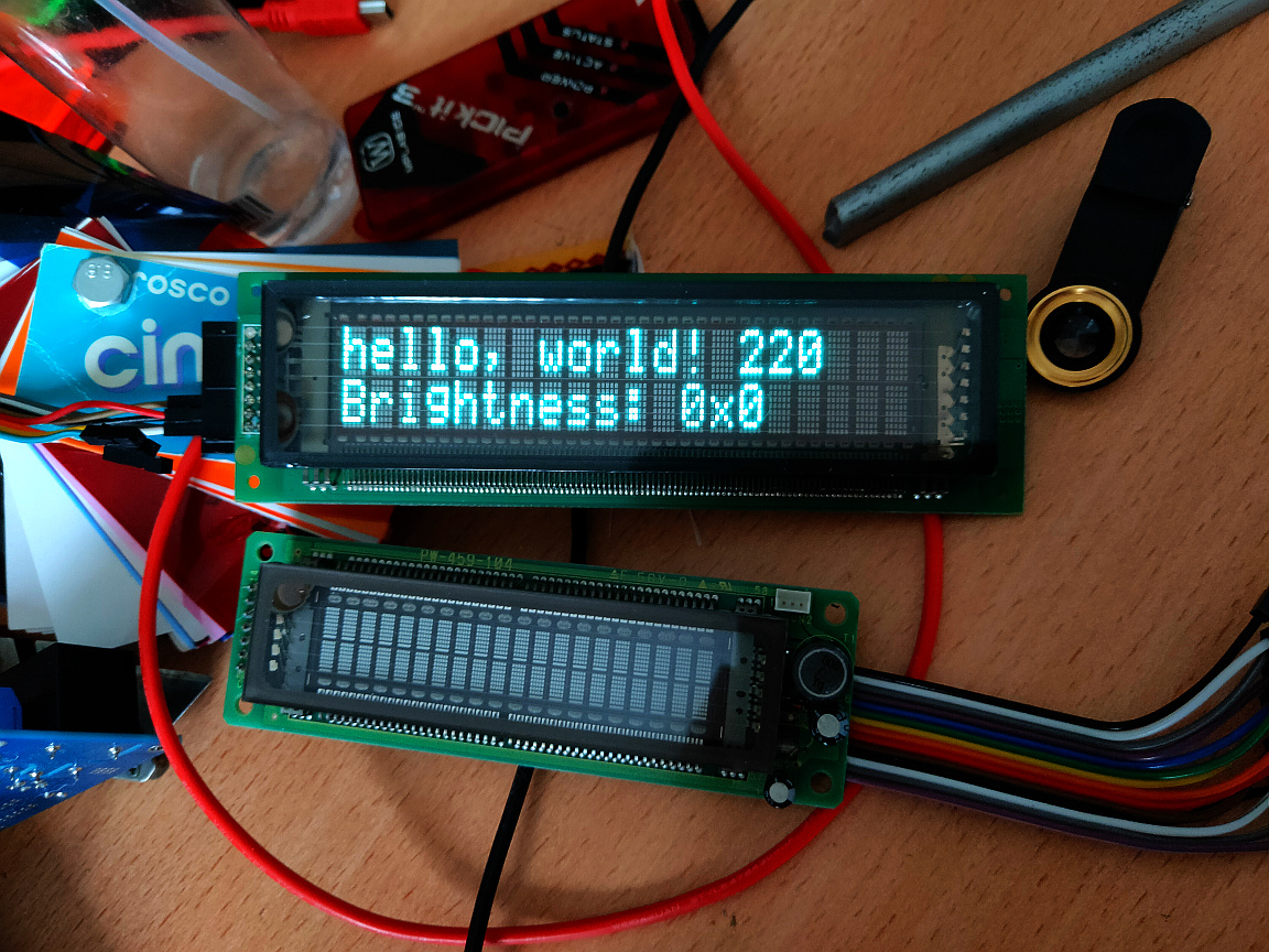

    But can't make it work with PBP

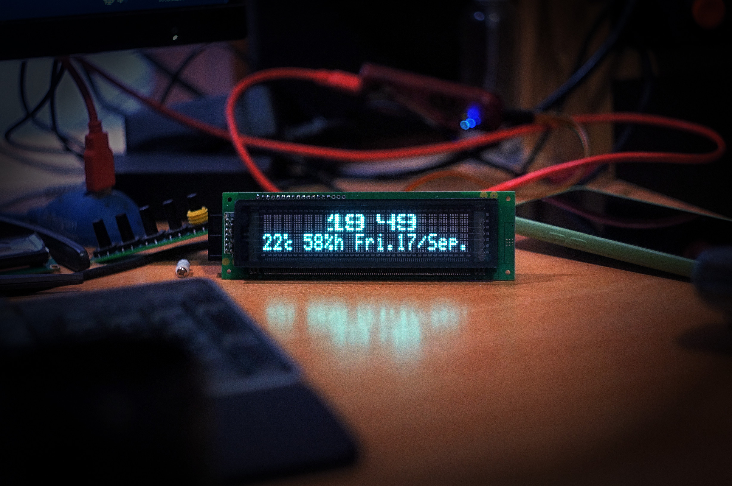

    So that's not a good idea to blame someone for not understanding things that you do understand.
