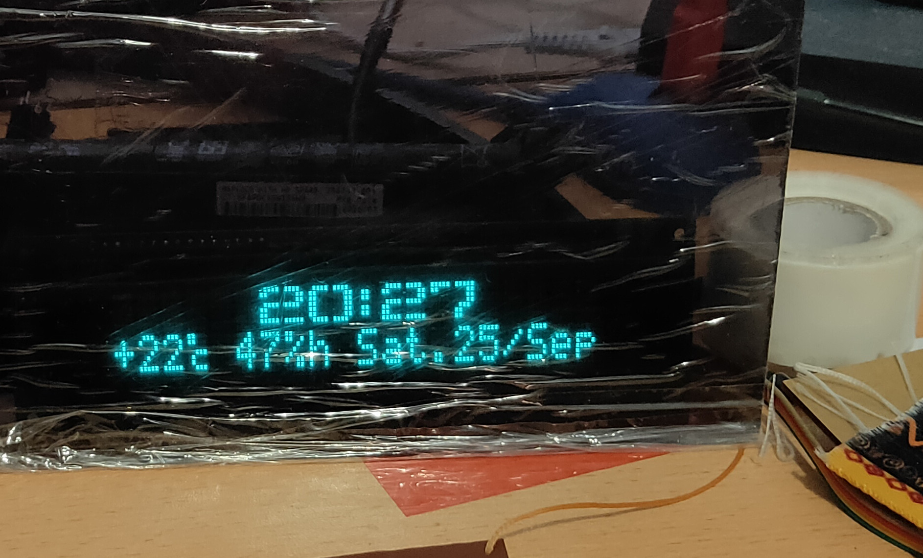

    I want to integrate it into my VFD clock project - I already have DHT22, DS3231, TTP223 up and running. So I wanted to add barometric pressure, to do some weather forecasting
    (Sorry for not removing protective sheet from filter, this is quite expensive material, a gift was send by Noritake, so I'm keeping it sealed till I'll go to final design stage and incorporate it into finished product).

    And this simple code fills up entire screen with white:
    LCDOUT $FE,$2E
    for Z=0 to 32
    LCDOUT $FE,$80+z
    LCDOUT $FE,$80
    FOR x=1 TO 18
    LCDOUT 255
    NEXT
    next

    Well, I have shifted letters to right edge, instead of left, and for text it indeed works, but when there is need to display the graphics...
    I'm using LCDOUT due it's simplicity and low memory use.
    The code below occupies less than 1k of memory (font data stored in eeprom), and allows you to have 4 lines X 18 characters text display with all custom letters on graphical display.
    C=0 '0=1st line, 8=2nd line, 16=3rd line and 24=4th line
    arraywrite topline, ["place text here   "]
    GOSUB GCODER
    stop
    GCODER:
    FOR X=0 TO 17 step 2	'READ ARRAY INTO VARIABLE, ARRAY MEMBER CHAR=EEPROM OFFSET
    Y=(topline[x]-65)*8
    Z=(topline[x+1]-65)*8 'READ  INTO VARIABLE AS TWINS
    FOR I=0 TO 7	'HELPER LOOP FOR CHARACTER READING
    READ Y+I,A 'READ EEPROM BYTES INTO VAR
    READ Z+I,B
    LCDOUT $FE,$80+i+c 'UPDATE Y POSITION
    LCDOUT $FE,$80+x/2 'UPDATE X POSITION
    if topline[x]=32 then a=0
    if topline[x+1]=32 then b=0 'blanker
    LCDOUT a
    LCDOUT b 'WRITE TO SCREEN
    'pause 10
    NEXT I
    NEXT X
