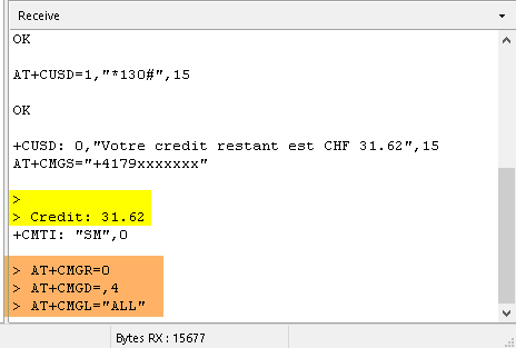

    I was wondering if there is any way to get out of a "sitting" situation from a GSM module when, i.e., a AT+CMGS is misissued.
    This situation I'll discribe further on should actually not appear since the program takes care to send "clean" SMSs.
    Since my project is about a GSM monitoring system, I would like to make sure the modem will always be functional even if something goes wrong.
    In this example, I've omitted the CTRL-Z command to terminate the message. This leads the module to hang showing ">" lines (yellow highlight).
    Appart from the next line +CMTI: "SM",0 indicating an incoming message, the next lines (braun highlight) are commands issued by my PIC but not recognized and therefore not executed. AAMOF, these three last lines are preceeded by a ">", the one that is probably waiting for AT+CMGS command termination.
    Unfortunately, sending a CTRL-Z does not finally terminate the AT+CMGS command and my module is stuck here until...I switch it OFF.
    Is there a way to get out of this trap?

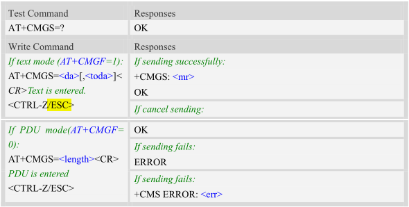

    In the AT command book for my module (SIM7600E), I finally noticed this:
    There is no mention of this ESCape command in the datasheet, just here in this table. But, unlike it is appearing, even if I cancel the CMGS command, I will get an OK.
    For any reason, I didn't understand that part of the DS (...as well as a lot of other parts, in fact ).
    Anyway, the ESC termination command does the job and cancels the AT+CMGS command and yelds an "OK" which I can wait for to "move on".
    Problem solved!
