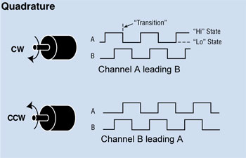

    1,930
    Default Re: Make PIC simulate binary up/down counter - how to calculate how fast can it count
    every edge [transition] is a decodable step for the encoder
    you catch each step with an edge triggered pin interrupt, you need a better chip , 16f1825 or something useful
