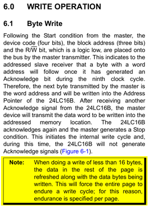

    I'm having trouble writing 8 bytes to a 24LC16B memory chip.
    In fact, I can write 8 consecutive bytes but it seems only the last byte I want to program is written to all 8 positions.
    Even after reading the DS many times knowing there is something particular when writing less than 16 bytes (...don't still understand everything for sure ), I can't see what am I missing.
    Name:  2020-12-29 21_37_13-Clipboard.png
    Any clue?

    This is what I get with your suggestion:
    EeCtrl=$a0 + 2 ;using block 1 ie 1<<1=2
        i2cwrite SDA,SCL,EeCtrl,0,[1,2,3,4,5,6,7,8]
    EeWP = 1
    Name:  2020-12-30 10_32_49-Window.png
    Something is also even more confusing to me. As you wrote, the address has to be WORD sized - this is also stated in the DS.
    In my code, I have it ("EeCtrl") as a BYTE. If I change it to a WORD, it doesn't make any difference.
    Your last suggestion with a WORD sized EeCtrl var gives this result:
    Name:  2020-12-30 10_42_42-Window.png
    Maybe I'm messing things up in the I2CWRITE command because I understand it this way and both vars (EeCtrl and EeAddress) are looking to be BYTE long:
    Name:  2020-12-30 10_52_01-Clipboard.png
    To be honnest, I don't get that thing with the WORD sized address...
    Roger
