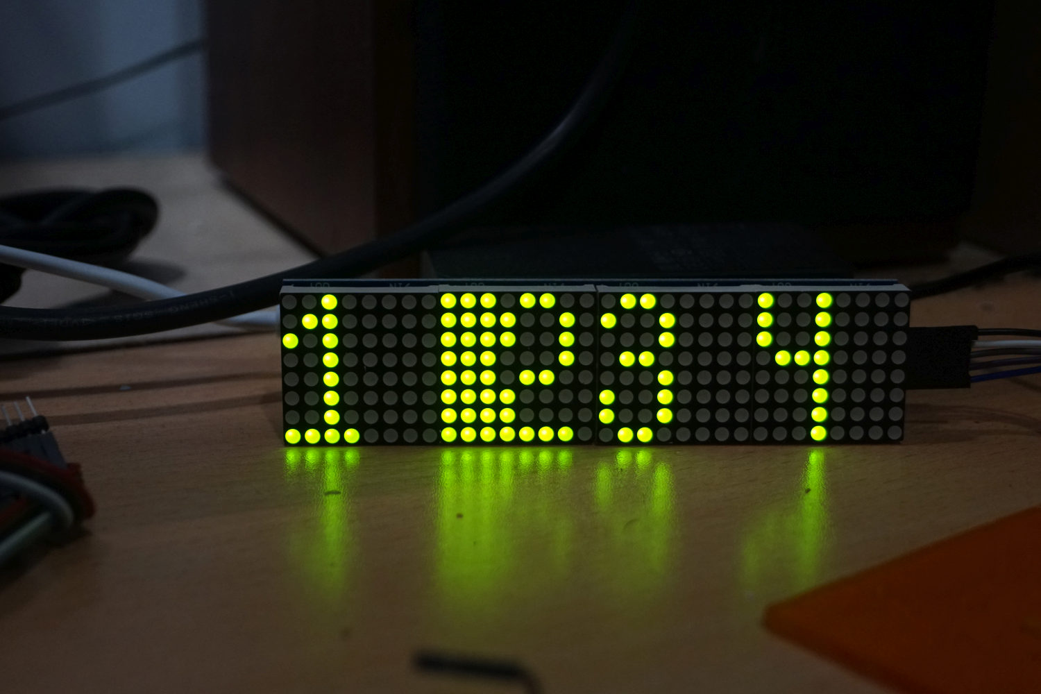

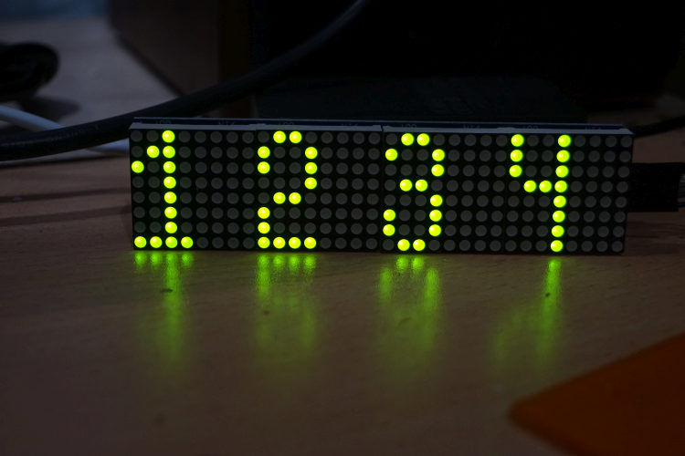

    Below is the code which works, but it works only if bits in array are aligned to bytes. If I want to shift them to make them less spaced (characters used have 4 pixel width, +1 pixel for spacing), image becomes garbled and shifted in wrong direction, as shown on attached pictures. What I'm doing wrong?
    DATA $60,$90,$90,$90,$90,$90,$90,$60 '0  'digits, left justified 4 bits used in each 8 bits
    DATA $20,$60,$A0,$20,$20,$20,$20,$F0 '1
    DATA $60,$90,$90,$10,$60,$80,$80,$F0 '2
    DATA $60,$90,$10,$60,$10,$90,$90,$60 '3
    DATA $90,$90,$90,$70,$10,$10,$10,$10 '4
    DATA $F0,$80,$80,$E0,$10,$90,$90,$60 '5
    DATA $60,$90,$80,$E0,$90,$90,$90,$60 '6
    DATA $F0,$10,$10,$20,$20,$40,$40,$40 '7
    DATA $60,$90,$90,$60,$90,$90,$90,$60 '8
    DATA $60,$90,$90,$70,$10,$90,$90,$60 '9
    INVAR=1234

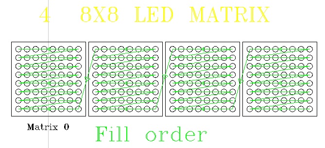

    1,840
    Default Re: Joining 5 bit variables and splitting them into 8 bit ones later?
    you are dealing with a matrix that fills like this

    its not a particularly easy format to leverage font images that traverse cells , and you cannot read back the data from the matrix

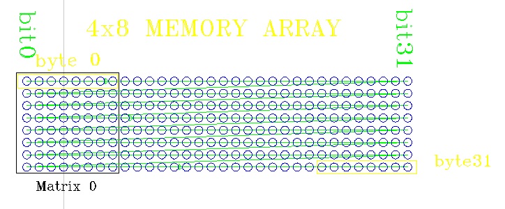

    to make life easy i would make a memory array [frame buffer] mapped to the matrix like this
    it's then quite straight forward to overlay a font chr into any location
    and then create a simple routine to write the frame buffer to the display
    in the bit order the matrix demands

    Well, I already have buffer, but 32x1 pixels in size, because the data is sent to display line by line.
    But the problem is different, I can't understand why this works only per 8 bit: SCREEN32[Y+8]=CHAR2.0(Y) - if I enter any other number instead of 8, which is not multiple of 8, say 5 or 17, everything becomes garbled, while it should not. So, maybe I'm writing in array incorrectly?
    I was able to solve this problem by replacing array with string of Boolean logic operations, but I'd like to keep array, because later I want to display more letters, with variable width...
    char1=char1 | char2>>5
    char2=char2 <<3 | char3>>2
    char2=char2 | char4>>7
    char3=char4<<1
    char4=0

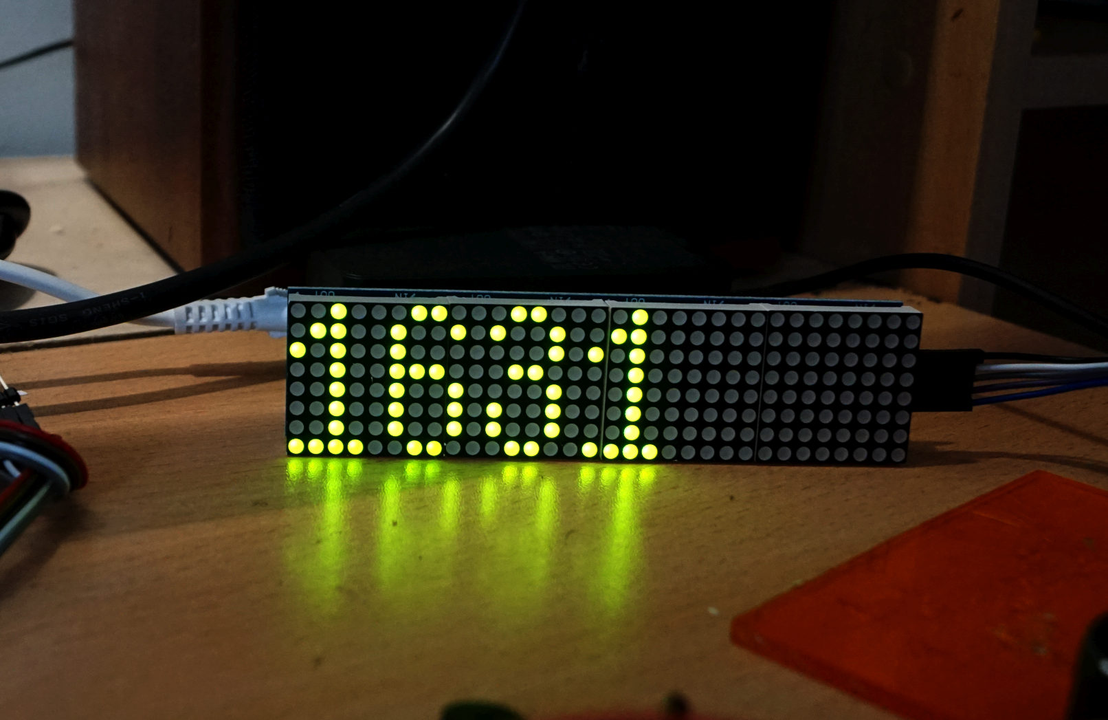

    And this is proof of my code working
    So if I understood correctly, there is no HSHIFTOUT statement, like HSEROUT ?

    But I still have an issue - why reading from a bit array from arbitrary position (not byte justified) returns garbage?
    1,840

    625
    Will take a look tomorrow...
    Meanwhile, added decimal point, C and F sign support...
