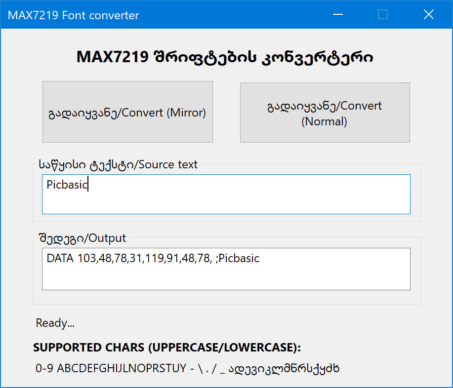

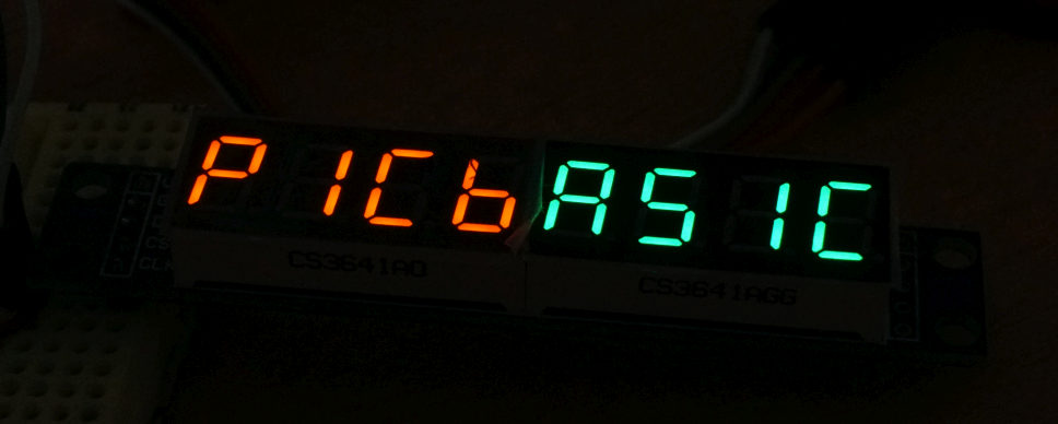

    I've written a PC based converter, which deals with ASCII conversion. It generates PBP code for EEPROM.
