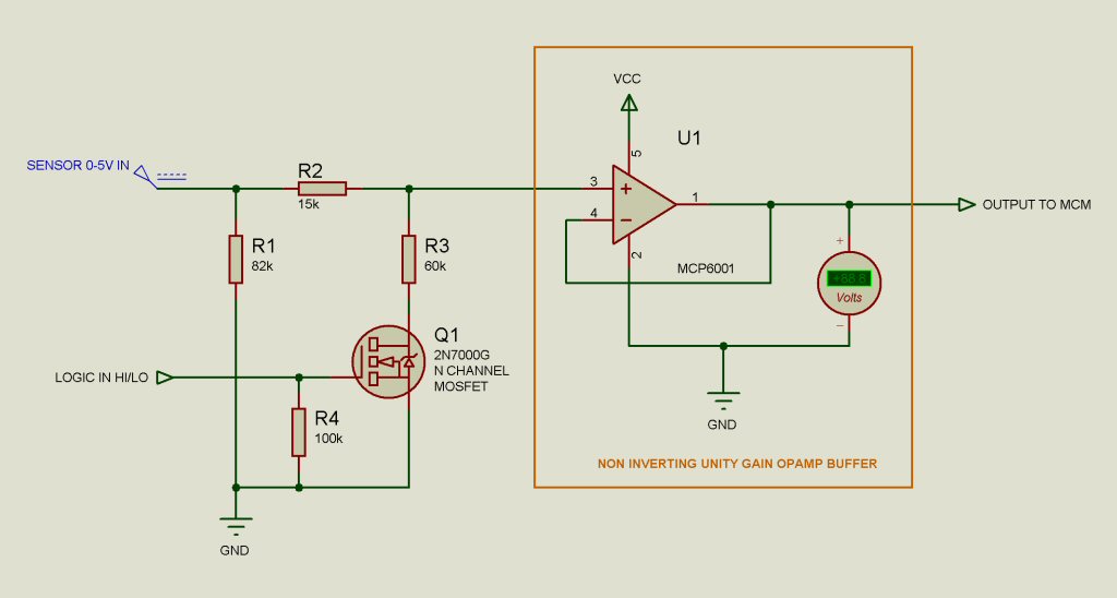

    Default Re: Current sensor output modification. PIC or opamp or something else?
    An example schematic of your idea would be kind Pedja.
    Thanks for responding.
    I basically have this so far.
    A potential divider activated by the MOSFET turning on and an non inverting unity gain opamp buffer.
    When the mosfet is on output is reduced by the PD ratio R2 and R3.
    R1 & R2 are out of my control in the equipment I am trying to modify.
    Name:  Switched OPAMP.jpg

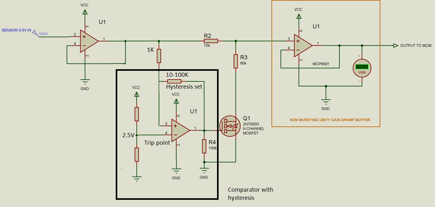

    You got most of circuit. I added one more buffer, so input to rest of circuit is low impedance. If you know your sensor output, you can omit first buffer.
    Second OPAMP create comparator with hysteresis.
    If input voltage excide trip point, output will be hi, so mosfet is turned on, and output voltage is reduced...
    Hi, Pedja ...
    you just redraw the TL431 !!!
    just have a look to its " OFF " state current ... : Off-State Cathode Current IK(off) VKA = 40V, VREF = 0 typ 0.26 max 0.9 µA
    Sep 2009
    755
    Sorry for that...
