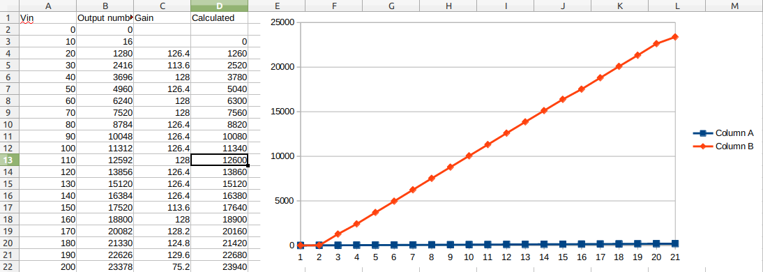

    After a little analyses, this is what I got
    Output numbers = (Vin-10)*126 (could be more like 128 as it is then a left shift operation)
    So, converting into a table, this is what I see
    Name:  Screenshot from 2020-11-05 08-16-12.png
    Hope this helps
    Default Re: How is this data being formed from the values given?
    Thanks for that very interesting..
