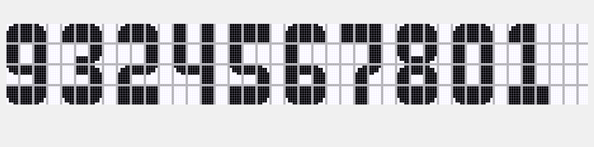

    Hello.
    I've created a large "font" from custom definable LCD characters, which look quite good. But to use with them with real software, I need a code which will translate some variable into these digit display. So to accomplish this, I've created two arrays, one for top row and one for bottom, which hold appropriate number of corresponding custom chars for the digit display. So to display the required char, I simply read values from arrays from index at that position and pass it to display. The code is as follows:
    DTOP VAR BYTE[10] 'array for top line
    DBOT VAR BYTE[10] 'array for bottom line
    DTOP[0]=21 '0
    DBOT[0]=37
    DTOP[1]=96 '1 9 REPLACES 16
    DBOT[1]=96
    DTOP[2]=05 '2
    DBOT[2]=24
    DTOP[3]=05 '3
    DBOT[3]=47
    DTOP[4]=37 '4
    DBOT[4]=96
    DTOP[5]=20 '5
    DBOT[5]=45
    DTOP[6]=20 '6
    DBOT[6]=35
    DTOP[7]=81 '7
    DBOT[7]=96
    DTOP[8]=25 '8
    DBOT[8]=25
    DTOP[9]=25 '9
    DBOT[9]=96
    QROMA:
    FOR CNT=0 TO 9
    LCDOUT $FE,$01,DTOP[CNT] DIG 1, DTOP[CNT] DIG 0
    LCDOUT $FE,$C0,DBOT[CNT] DIG 1, DBOT[CNT] DIG 0
    PAUSE 1000
    NEXT
    GOTO QROMA
    But I run into problem, since I'm using "space" for some characters shape, namely 4, 7 and 9 and DEC code for space is 16, I can't put it into that arrays. In fact I can put it, but when I read array like I do in example code, with DIG statement, it will get ,messed, because say I need to display space at left and 6th custom char at right. If I put 166 into array (16 for space and 6 for that custom char), when I read it, the DIG 1 will return 6, not 16.
    So what can I do? One way I see is to use individual array elements, and omit usage of DIG, but this doubles array size.
    Any other ideas?

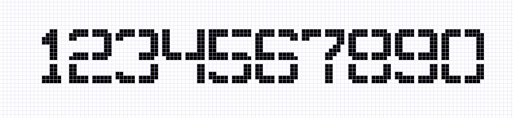

    Here is my font for 20x4 LCD displays. Far better than posted in the link above.
    4,175
    Default Re: Replacing array member on the fly (big LCD characters idea)
    Really nice job on the big numbers.

    Thanks. I have experience of making pseudographics (so called ASCII art) since early 80s. That set of characters also can be used to display most latin alphabet letters, except some. Regarding the LCD, I have no idea, but above example uses serial LCD and I don't see any PBP manual entries for serial LCD.

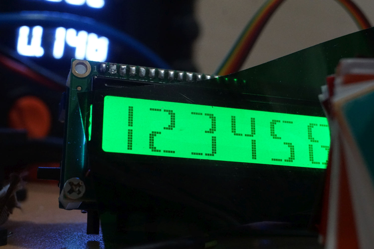

    Here's 2x2 font for 1602 OLED (Here you can write bytes directly, not limited by 8 custom chars).

    Found interesting thing. On power up, custom character area in normal LCD are empty, but on WS0010 OLED displays, they are filled with random numbers on power up.
    4,175
    On the custom character, unless explicitly stated, you should consider it full of rubbish.
    Feb 2013
    1,159
    Yes, but on LCD it is usually empty. On OLED - it is filled with different garbage on each power up.
    Anyways, problem solved, also did some nice animation, will post code and video later.

    Here I was having fun with animation process - direct reading from EEPROM is a new thing for me. I already have clock code written to use these 2x2 chars, will post it after I'll tidy it up.
    Graphical screens might be good but 1602 OLED have 2 advantages:
    1. We know the interface.
    2. They're cheap for their size (comparable physical size Graphical OLED is more expensive)

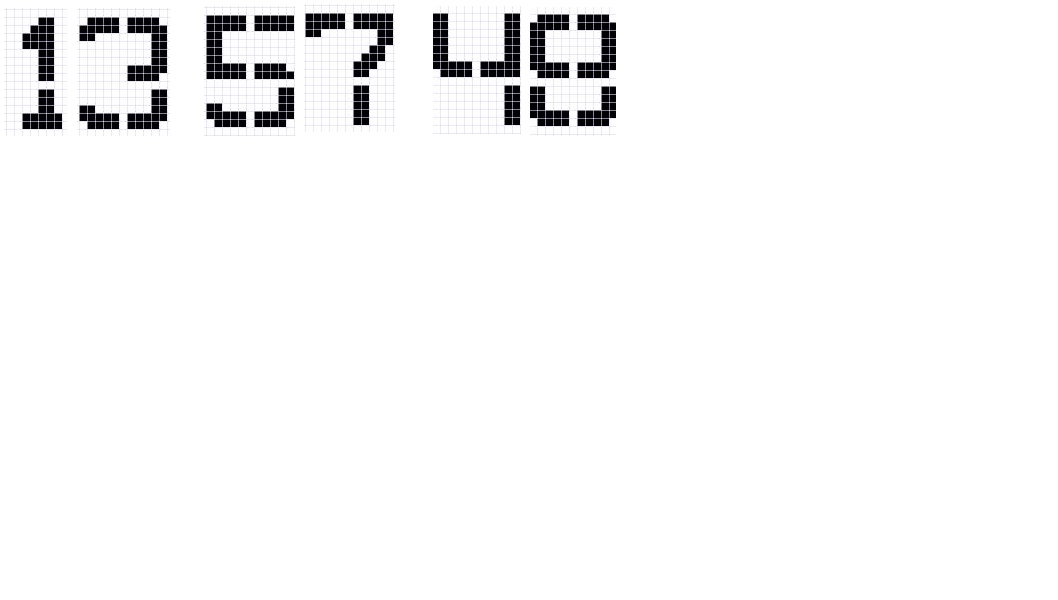

    the font you depict has 22 "shapes" that i can see, the display can hold only eight user defined [cga ram] shapes at any one time
    try to show this

    Will be doing mechanical counter animation next
    Feb 2013
    1,159
    With timings adjusted, it looks quite good even on normal 1602 LCD.
    4,175
    Indeed, it looks very nice! Nice work.
