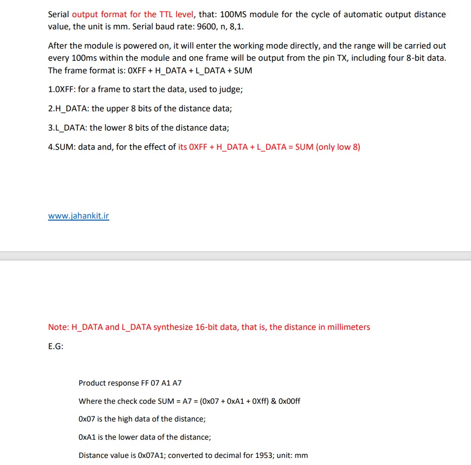

    I need a little help with this task. I want to read data from Ultrasonic distance meter which put out every 100ms serial data.
    The protocol is here:

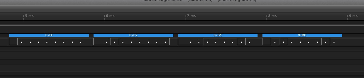

    The captured data looks like:
