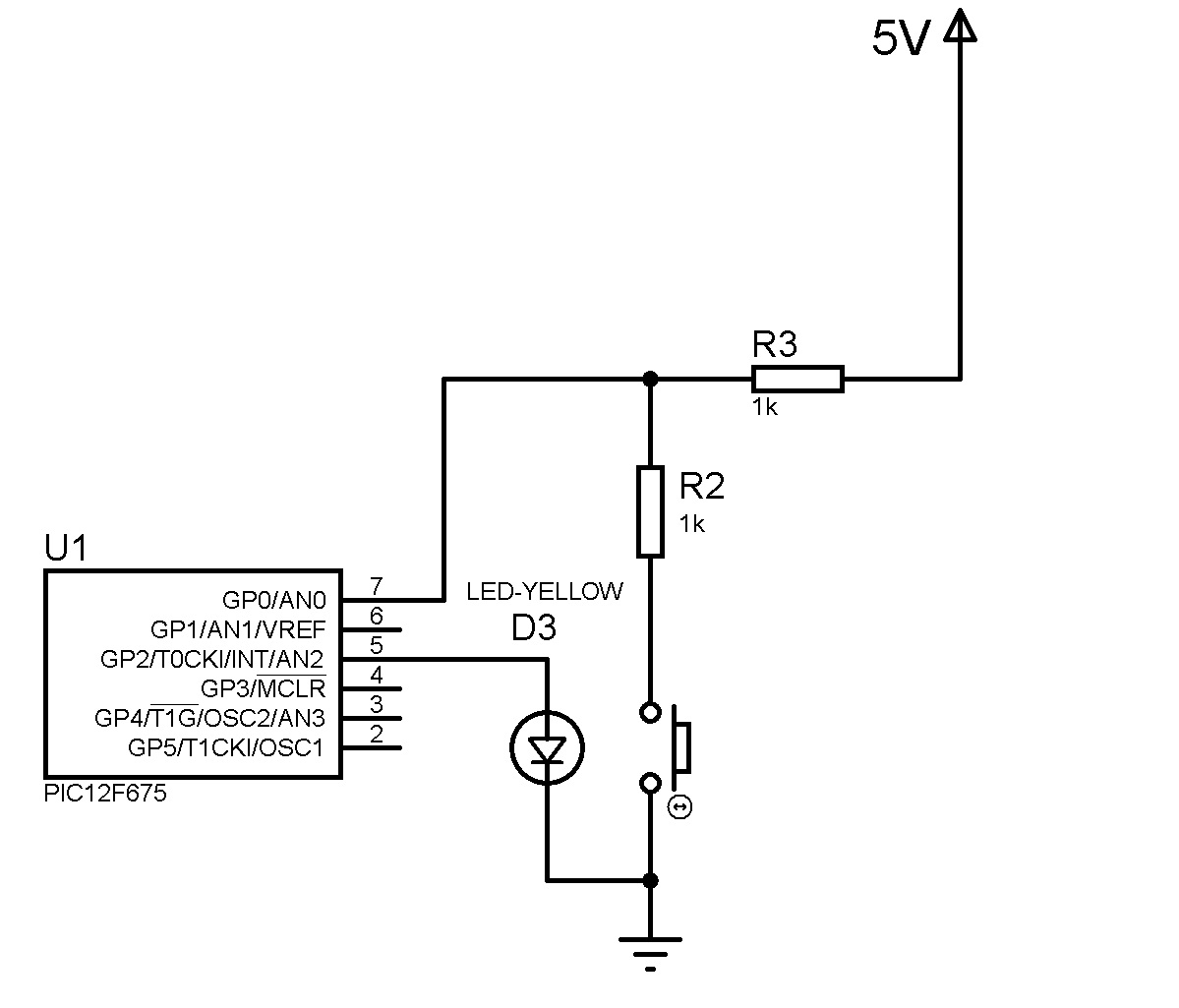

    Hi ! Both of my dispensers stopped working. So I thought of making a module with PIC. However, I encounter problems when implementing the function @Sleep in the program. I need your advice .... Thansk !

    It's the first test ... simulating IR detector by resistor and reading the ADC.

    I think you have it a bit mixed up!
    First, a voltage divider like that will not trigger IOC reliable or at all.
    Second, in case of an interrupt what should the program do? You do not have an ISR to jump to.
    Third, read the manual regarding the On Interrupt command to make a ISR subroutine.
    The main idea is to make a digital input with preferably internal pull-up enabled. Then, an external trigger on that input will start PIC and jump to ISR.
    In the ISR, you can recheck the input to make sure the trigger was real and then set the output for 4 sec. Then clear Interrupt flag, reset the output and go to sleep again.
    1,731
    Default Re: Advices required for Soap dispenser / sanitizer code
    i assume you intend the button to cause an ioc interrupt to occur when pressed.
    it wont because any i/p pin set as analog will always read as low so a pin change event
    will never occur
    why would use adc to react to a button anyway ?
    This is more entertaining than Free to Air TV
    2,973
    I can only guess that it is not a clear 0-5 volt state.
    And that is why he simulates the trigger pulse with the two resistors. All the way wrong approach...

    Thank you for the answers. The 2 resistors and the button simulate a photodiode, whose resistance increases when it is no longer illuminated by the IR emitting diode (communication is interrupted by the hand interposed on the route). There is NO button !

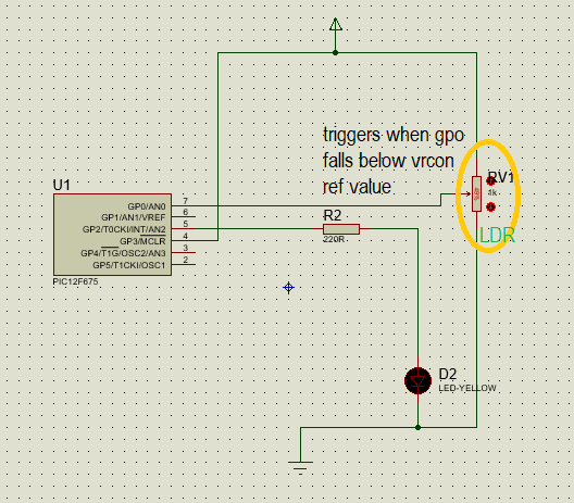

    At work, we make a product that detects hand motion to light up a string of LED's. You can use a FET to drive the soap pump motor. We use the ADC in a 12F675 to detect fluctuations from a 5528 LDR. ADC has 47K pull down resistor, other side of LDR to B+.
    1,731
    IF you use the comparator its as simple as this.it won't re-arm itself until hand is removed

    Thank you very much ! I think this is what I need ! I will tested and post the results. Regards !
