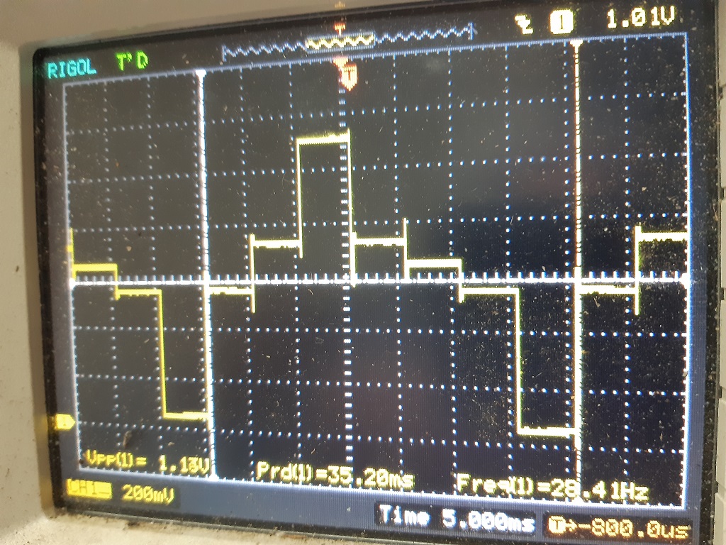

    Default Re: Weirdness with 16F1705's DAC
    Hi Folks,
    I went ahead and made a pcb for the application and during layout decided to use the alternate DAC output of RA2 instead of RA0 to keep it free for ICSP.
    Of course after etching and populating the pcb I have some nonsense happening on RA2 despite correctly reconfiguring the DAC registers (at least I think so!). The code below compiles, loads and runs correctly when configured for RA0 but RA2 Sits at 2.277V with RA0 running correctly. When set for RA2 it sits about 700mV varying slightly and RA0 is at 0V as you'd expect.
    Have I missed something or am I having another senior's moment? While I can hack my pcb to achieve a solution using RA0 I'd like to have the option of being able to use RA2 as it was intended.
    Thanks, stay safe,
    Bill

    Default Re: Weirdness with 16F1705's eeprom and DAC
    Hi Richard,
    Thanks for looking into this.
    I edited my previous code to match yours and the results are crazy - see both 'scope captures below. RA2 is changing the right steps but is offset by about 700mV.
    Only difference to code between the two is altering DAC1CON0 to achieve the change in output pin. I thought I might have a dud PIC so changed it but no difference...
    Any ideas?

    2,714
    new code without all the noisy comment
    with both outputs driven , from fvr buff2 @2.048v [1.024v got weird results]
    the unmentioned feature in data sheet is that out2 is complement of out1 and the gain seems a bit different
    ps blue trace is dacout1
    Yes, same as yours Richard.
    As a side note I looked at substituting the 16F1705 with a 16F1614 but it only has out1, again on RA0 so did not proceed.
    But out2 for me (1705) continues to have the DAC variation superimposed on a 700mV offset no matter what gain I have (x1,2 or 4). The comlementary/inverted output appears to be an undocumented "feature", may have its uses down the track, although I don't understand why the difference in gain between the two.
    I tried an external Vref of 1.2V (LM385) and the waveforms appear stunted - may be due I didn't buffer the ref output - however the offset remains and this is the key problem.
    Only when I used Vdd as Vref did the offset disappear but in the intended application I need the 1.024V reference, so Vdd is useless. I can use an external DAC (and get some greater resolution at the same time) but it defeats the purpose of using an all-in-one PIC in the first place, plus the pcb is already done albeit a prototype for my needs so I can hack it to use out1.
    I won't waste anyone else's time pursuing this further, it is what it is - warts and all...
