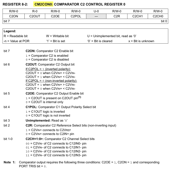

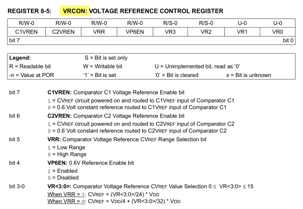

    These are the registers:

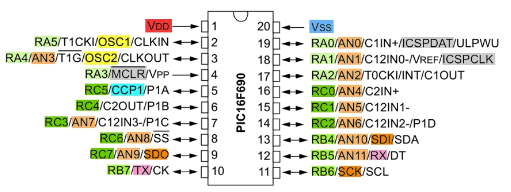

    And this is my PIC:
    My voltage divider (that comes from Vbatt) is connected to PORTC.3 and I'm expecting the PORTC.4 (C2 output pin) to trip when Vbatt exceeds 0.6Volts, but this nevers happens.
    What am I missing please?

    this works if you mean "trip pin" means pin is set when below 0.6v and cleared when over
    #CONFIG
    __config _INTRC_OSC_NOCLKOUT & _WDT_ON & _PWRTE_OFF & _MCLRE_ON & _CP_OFF & _CPD_OFF & _BOD_ON & _IESO_ON & _FCMEN_ON
    #ENDCONFIG
    ' ====== REGISTERS ================================================== ===============================
    ' Registers 76543210
    OPTION_REG = %10000000 ' PORT A&B Pull-Ups and Prescaler (def.: %11111111)
    OSCCON = %01100000 ' Internal Oscillator 4MHz (def.: %01101000)
    TRISC = %00001000 ' Set Input/Output (0 to 7) (def.: %11111111)
    led var portc.0 ; proof of life
    CM2CON0 = %10100111 ' Comparator2 Module (def.: %00000000)
    ' Bit1/C2ON = Comp C2 is ON
    ' Bit5/C2OE = Output is PORTC.4
    ' Bits1-0 = Input is PORTC.3
    ;bit2 connect c2+ to fvr output
    ansel.4=0 "just to prove c2+ is not connected to this
    VRCON = %00110000
    ' Bit2/C2VREN = Comparator C2 voltage ref is ON
    ' Bit4/VP6EN = 0.6V ref is ON
    ' ====== DEFINES ================================================== =================================
    DEFINE OSC 4
    ' ====== PROGRAM START ================================================== ===========================
    MAIN:
    toggle led ; proof of life
    pause 1000
    GOTO MAIN:

    Unlike the video, I started with a 2 resistors divider. But a potentiometer (maybe easier for a start) and a corrected register CM2CON0 as you suggested made it work.
    So, I missed this one you kindly pointed me to:
    Finally, the "shortest possible" working code for a 0.6Volt threshold detection could be:
    TRISC      = %00001000 ' Comparator's input port
    CM2CON0    = %10100111
    ' Bit7     = comparator 2 is ON
    ' Bit5     = comparator's output pin (i.e. LED) is PORTC.4 (for "proof of life")
    ' Bit2     = connect Vref to C2Vin+
    ' Bits1:0  = comparator's input pin (i.e. Vbatt) is PORTC.3
