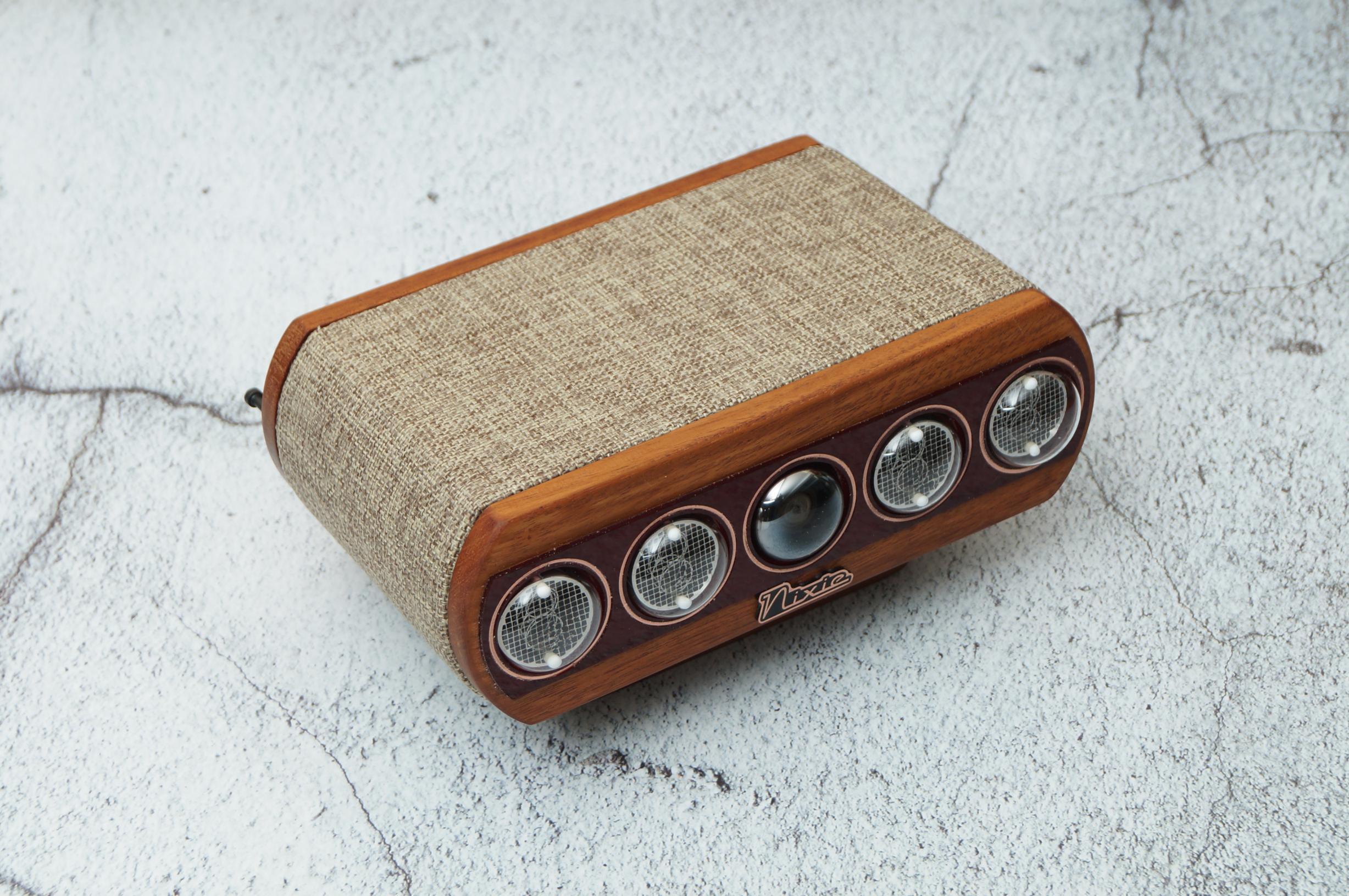

    Hello, I'm adding an OG-4 decathron tube to my open source nixie clock project. It being run by separate PIC and own power supply. The tube has following pins, which are being driven by MPSA42 transistors, controlled via PIC12F683. These pins are

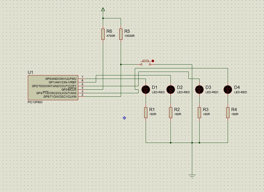

    I've developed very crude and inefficient code for that, which runs on 12F683. I only have made animation till 10th dot and it already using 1k of available chip memory. Of course, I can switch to say 12F1840, but code is still not that good - any attempt to add say 2 times making the same rotation needs complete code rewrite. So is there a way that my code can be optimized? or I have another idea, Decathron tube can be considered as a kind of shift register, so maybe there is another, more efficient approach of doing the above task?

    Schematic is simple, there are 4 MPSA42 transistors, each of which is connected via 10K resistor to corresponding ports (ZERO, ONE, TWO, TRE) as shown in code. GPIO.5 is tied via 10K resistor to VDD, and button pulls it to zero.
    Only addition to code above is
    koka:
    if GPIO.5=0 THEN 'if pin pressed
    goto tavi 'launch rotation
    pause 1
    GOTO KOKA
    1,640
    Default Re: Controlling OG-4 Decathron with PBP in an efficient way.
    and post your code and a schematic so we don't just keep guessing
    i mean post the code you are using now!
    i'm likely to make mistakes going back through several pages of add infested forum to try and patch together what i think you may be using.
    and even a hand drawn schematic makes things clearer

    the code compiles and runs flawlessly in proteus, thats not the issue , check your circuit

    Check for what?
    If I replace TRISIO=%00101000 with TRISIO=%00001000, it will also work fine (but without a button).
    1,640
    put an oscilloscope/logic analyser on gpio.4 and see what the signal looks like or if you don't have one
    put a led on gpio.4 in lieu of whats there now if it does not change state when gpio.5 is read then whatever is on gpio.4 is loading pin excessively.
    or else your description of the problem maybe unclear or inaccurate

    sub9 'subroutine for spinning - it is there
    The whole circuit is assembled into box and potted with epoxy, so have no access to pins, except GPIO.5, I can check it with scope if needed.
    1,640
    only by mcs's good grace to call anything unknown a label, the colon is missing
    that would be me out .

    I potted it because it worked very fine, until I added that input parsing code
    I can build another one, that is not an issue...
