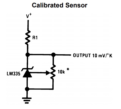

    Hi, I'm always grappling with my firmware on the PIC 16F88 trying to dust some programming.
    1) Ascertained that as PIC I have 16F88
    2) My temperature sensor is an LM235H
    3) located on analog port 0 (PIN17)
    4) The assembly scheme of sensor is:

    I believe you are going wrong by not subtracting the zero degree C. offset before you calculated the final value of quanta. Here is what I calculate:
    0 degrees C. = 273.15 degrees K.
    273.15 degrees K. x .01 volts = 2.7316 volts @ 0 degrees C.
    5 volts / 1023 counts = .004887586 volts per count
    2.7315 volts / .004887586 volts per count = 588.86484 counts
    588.86484 raw counts = 0 degrees C. = 273.15 degrees K.
    After subtracting the 588.86 counts from the raw reading, you end up with:
    .01 volts per degree C. / .004887586 volts per count which equals 1 degree C.
