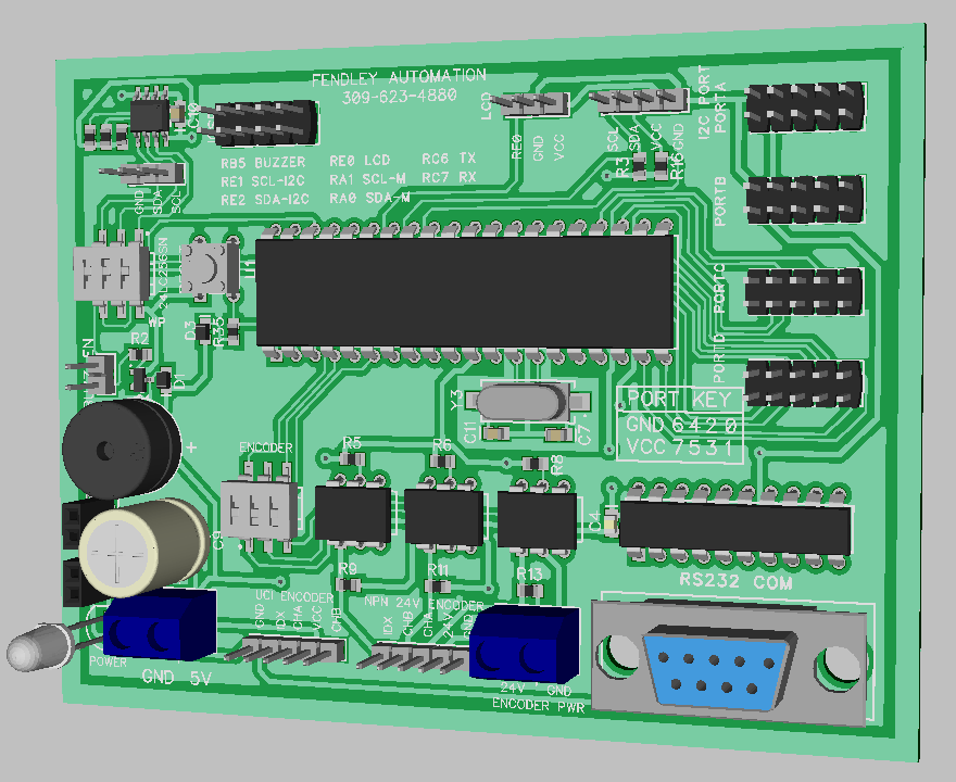

18f4431 PORT.5 Problem Large automated machine
Results 1 to 13 of 13
    Jan 2010
    21
    Default 18f4431 PORT.5 Problem Large automated machine
    I don't post much but last night I was work on finalizing a hserin interrupt routine for a project I'm working on. I'm using pic18f4431 portb.5 as an output for a buzzer on my main board. I normally just hook my scope to a jumper pin for portb.5 to monitor as a heart beat. Anyway I've used this main board in many projects so I know there are no hardware issues. But for some reason after testing the hserin routine portb.5 stopped working. I've tried everything I know, I wrote a simple program just to toggle portb.5 and portb.6. Portb.5 nothing sitting at zero volts portb.6 10ms square wave. I've tried a new chip as well and I can't seem to get this running. I haven't seen this before but the fact that even a new chip won't work leads me to believe some obscure setting is wrong and can't find it. The crazy thing is that I loaded my original code back to the board and portb.5 no longer works. So it has to be a setting of some sort.
    If anyone can help me get this going I'll post a full project and video of a large feed to length automated machine I'm finishing up. Thanks
    Little test program:
    ;----[18F4431 Hardware Configuration]-------------------------------------------
    #IF __PROCESSOR__ = "18F4431"
      #DEFINE MCU_FOUND 1
      CONFIG  OSC=XT, FCMEN=OFF, IESO=OFF, PWRTEN=OFF, BOREN=OFF, BORV=20, WDTEN=OFF
      CONFIG  WDPS=512, WINEN=OFF, PWMPIN=OFF, LPOL=HIGH, HPOL=HIGH, T1OSCMX=OFF
      CONFIG  FLTAMX=RC1, SSPMX=RC7, PWM4MX=RD5, EXCLKMX=RC3, MCLRE=ON, STVREN=ON
      CONFIG  LVP=OFF, DEBUG=OFF, CP0=OFF, CP1=OFF, CP2=OFF, CP3=OFF, CPB=OFF
      CONFIG  CPD=OFF, WRT0=OFF, WRT1=OFF, WRT2=OFF, WRT3=OFF, WRTC=OFF, WRTB=OFF
      CONFIG  WRTD=OFF, EBTR0=OFF, EBTR1=OFF, EBTR2=OFF, EBTR3=OFF, EBTRB=OFF
    #ENDIF
    ;----[Verify Configs have been specified for Selected Processor]----------------
    ;       Note: Only include this routine once, after all #CONFIG blocks
    #IFNDEF MCU_FOUND
      #ERROR "No CONFIGs found for [" + __PROCESSOR__ +"]"
    #ENDIF
    '---[OSCILATORS]----------------------------------------------------------------
     DEFINE OSC 8
     OSCTUNE = %00000000
     OSCCON = %01111000
    '---[CAPTURE COMPAIR MODUALS]---------------------------------------------------
    CCP1CON = %00000000
    CCP2CON = %00000000
    '---[ANALOG CHANELS TO DIGITAL]-------------------------------------------------
    ANSEL0 = %00000000
    ANSEL1 = %00000000
    ADCON0 = %00000000
    '---[CONFIGURE PORT]------------------------------------------------------------
     TRISB = %00000000
      LATB = %00000000
     PORTB = %00000000
    '---[ Alias ]-------------------------------------------------------------------
    BUZZER VAR PORTB.5
    BUZZER2 VAR PORTB.6
    '---[ MAIN PROGRAM]-------------------------------------------------------------
    MAIN:
    TOGGLE BUZZER
    TOGGLE BUZZER2
    PAUSE 10
    GOTO MAIN

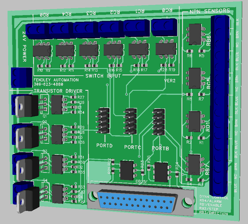

    Well I finished up the machine and delivered it. My client is thrilled and has more automated machines he wants me to get started on. But like I said I'd post a little about this project. This machine is for a very progressive framing company that is automating every aspect of their business. This machine will except window and door water proofing seal from 4" to 30" wide and interface with their software over USB. They have an in house software engineer that writes all their custom software to break a job down and minimize waist. Every aspect of their framing is maximized through automation. I worked with him over the internet interfacing my control with his software and after a handful of emails and a couple calls we had it debugged and running. Minus my original post here which was a late night, frustration and a wrong configuration bit. It bites us all at some point. So here is the youtube video of the project in front of my shop.
    Also the main PCB and secondary interface PCB for using the DYN4 AC servo drive and all inputs and outputs. I'm using a pic18f4431 on the main board because it's a handy controller with and easy to use quadrature encoder. It's one of my basic boards I always use designed in diptrace. Here are some pictures.
