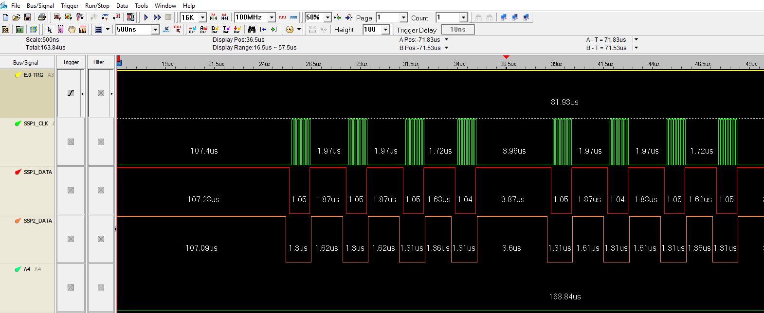

    Default Re: Confirm 18f47k40 MSSP setting and allocation using PSS
    in this config ,if microchip had considered it would have been nice to allow the master and slave not to have a data input pin Have to be assigned , allowing for them to be used as I/O
    the master where no slave is needed still need the data input port assigned in PPS and SSP from the setting i have seen

    2,389
    a spi port without sdi would not be a spi port it would be something else.
    not sure what you mean by ssp . ss=slave select,its an input pin.
    a spi master port has no ss pin there is no such thing as ss out, ss is an optional input signal for spi slave ports.
    the master device needs to assign a separate i/o pin as a cs to drive a slaves ss pin if its required. the mssp port does not provide that function.
    nice to see you have it up and running, for the record what did you have wrong earlier that stopped it functioning?

    Font char sets is needed or should say font msg sets stored in external flash is need later on , so i really hope this week to get a the displays to do something meaning full
    i still not seeing Oe, Lat working correctly , which is i think is bad port rewiring , but will know soon enough
    the main problems with interupt routines reassign to timer2 , timer 3 used a gate pin , when was not needed , setting correctly fix it, but it effected timer 1 and as such it created other issues ,
    SSP1 PPS was right , but SSP2 was not correct on the PPS originally , finally sorted that by reviewing settings, i spent a lot of time trying to make mplab -code configure to show what i wanted , which was a problem
    as it turns out this chip is doing a lot of other things ,not just getting the outputs for p10 going correctly , which is so important , rf modual , terminal services , it also doing some logging of sensors ,voltage monitoring has remote config of settings, etc
    timers 0-4 in use , 8 related INT services ,
    Anyway see how the next days progress ill send you a commented code list of what i think is happening ,so i can follow the structure design , if you can have read see if i got wrong
    Cheers
    Sheldon
