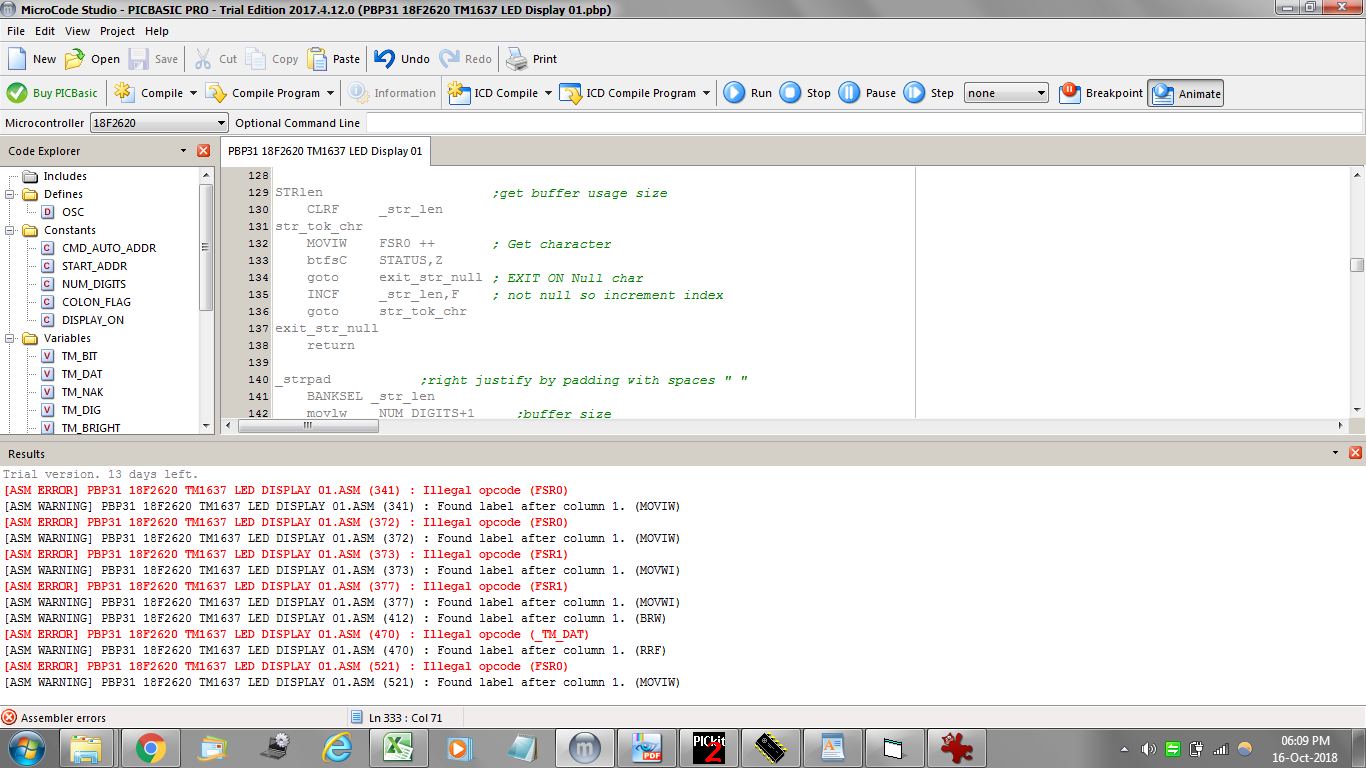

    Couple of days back, I downloaded PBP 3.1.1 with the idea of trying it out and to compile codes written for Ver 3 and above.
    I used your demo code (TM1637-DEMO.pbp.txt), made suitable changes for PIC 18F2620 at 32MHz, configured PortB pins 0, 6 & 7 for LED, DIO & CLK respectively and made the required changes in the ASM section for the same. But on compiling, many errors are reported like "Illegal opcode (FSR0)" and "Found label after column 1".
    Attached is my code and the screenshot showing the compilation errors. I am clueless as to where the issue is and your help is appreciated.

    Screenshot showing errors:

    MY code is for a pic16 with enhanced core it needs some changes to operate on older chips and/or pic18
    moviw fsrx ++ can be replaced with
    MOVF INDFx,W
    INCF FSRx
    brw becomes
    addwf PCL, F ; as long as you don't overflow pcl
    pic 18 has no rrf code
    repl with rrcf
    PIC 18F2620 version , not tested did compile ok
      CONFIG  OSC=INTIO67, FCMEN=OFF, IESO=OFF, PWRT=OFF, BOREN=SBORDIS, BORV=3
      CONFIG  WDT=ON, WDTPS=512, CCP2MX=PORTC, PBADEN=OFF, LPT1OSC=OFF, MCLRE=ON
      CONFIG  STVREN=ON, LVP=OFF, XINST=OFF, DEBUG=OFF, CP0=OFF, CP1=OFF, CP2=OFF

    I used your 18F2620 version of the code for TM1637. It compiles OK, but in the subsequent test with the 18F2620 on a breadboard, the LED lights up and stays lit without anything happening to the LED module. In order to make sure that the PIC is working, I added a For-Next loop to make the LED blink 3 times for 500mS each as a diagnostic routine before the main code executes. Now, the LED blinks correctly telling me that the PIC is working properly at 32MHz. But this is what happens: 3 Blinks, gap of 1 second, 3 blinks and so on. I feel, the PIC is getting reset repeatedly.
    Then I tried your original code with 12F1840. The compilation goes through without any errors. But when tested with the LED module, the LED stays lit and the TM1637 LED module does not light up.
    Please let me know if you want me to post the code I used for the two PICs.

    Compiled your code for 12F1822 for 12F1840 after adding the 'Blink LED 3 times' routine. Compilation went through without a hitch followed by programming a 12F1840. When tested, the LED blinks 3 times and goes off. Nothing else happens.
    Compiled once again, this time changing the uC to 12F1822 in MC Studio. Again, the compilation went through fine. But on testing, the LED blinks and goes off, but the LED module does not come to life.
    There is one more strange thing I am encountering. A month back, I bought 5 pieces of 12F1840-I/SN (SOIC package) from Ali Exp for $ 3.22. The laser printing/etching on the chip clearly shows "12F1840" and it works at 5V without any problem. But PICKIT2 identifies it as 12LF1840 and the voltage will not go beyond 3.6V. Of course, even if I use an LF version of the PIC, the TM1637 LED module should work. Every now and then, I connect the module to a Nano and check in order to make sure that there is nothing wrong with the module. Whether the voltage is 5 or 3.3, the module works fine. Understandably, the brightness is less at 3.3V.

        OSCCON = $60   '4 mhz
        OSCTUNE.6 = 1  'PLL Enabled
    DEFINE OSC 16    '16MHz (4X4 = 16)
        TRISB.4=0
    '    ANSELH=0          'Not applicable to 18F2620
        ADCON1 = 15        'Disable ADC
        LED    VAR  PORTB.4  ' Assign name "LED" to
        USERCOMMAND "DISPLED"    ; BUFFER{,COLON }
        USERCOMMAND "STRLEN"     ; BUFFER
        USERCOMMAND "RJUSTBUFF"  ; BUFFER
        TM_BIT        VAR BYTE BANK0

    2,090
    Default Re: How to use TM1637 chip for LED Display?
    WOW! FINALLY, IT HAPPENED!!
    The TM1637 LED display module came alive!!!
    I used your revised code for 18F devices and after I made a few changes in the CONFIG section, the compilation for 18F2620 was successful.
    very good. you would have to wonder why the 12f1840 did not work
    I changed the Osc speed from 32 to 16MHz. Later, I tried the code at 8MHz and 4MHz. It works beautifully at those speeds too.
    the code works up t0 64mhz and can write the 4 digits in less than 50uS
    Warning I'm not a teacher , prose like a gushing embroilment is not my style
