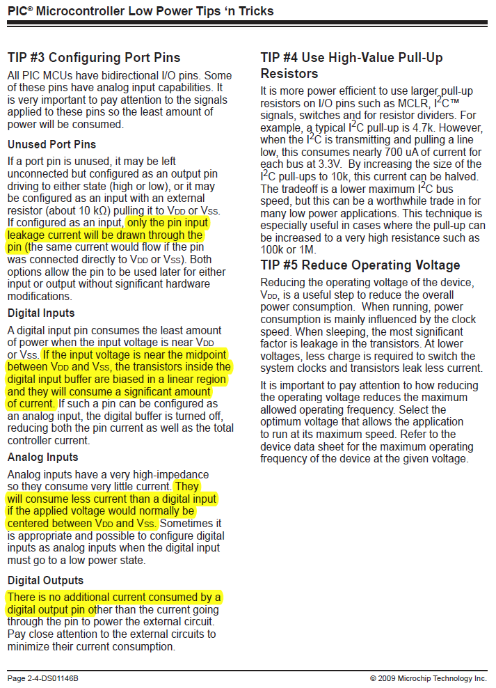

    4,144
    Default Re: GPS Project: PIC18F26K22 or PIC18F46K22
    I have my doubts on leaving inputs floating.
    Usually if I have any unused ports, I turn them as outputs and clear them.
    If they are inputs, maybe enable the pull ups if any or tie them to ground.
    A floating pin can cause troubles in certain cases.

    4,144
    No the program itself but on the total current consumption as the CMOS do not like to be float.

    4,144
    Depends. If you care about minimum current as is the case in battery operated devices, then yes. Do set them as inputs with proper pull up enabled inside the PIC or a large size output.
    I found that makes no difference, at least for the chips I used, to set them as outputs logic low, and use no pull up or down. Pull up/down can also contribute to current consumption.
    I attach the page 2-4 of the Tips and Tricks, file DS01146B regarding I/O that has more info on this.
    Oct 2010
    413
    I believe that any input pin must be pulled either up or down depends on the use. If there is a switch normally most of the people, pull up a resistor at the input pin, and the switch goes to ground.
    Now for the rest of the pins personally if the pins are output and digital, i leave them floating, but i use the command:
