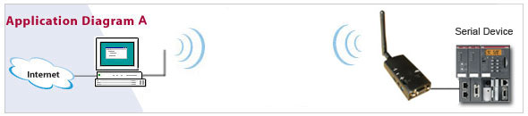

    Hello All,
    I'm looking around for some serial-to-Wifi modules connecting to a Wifi virtual com port on the PC.
    The only product I found up to now is this one here: http://www.tronicore.com/en/serial-wifi-adapter
    This example shows an "ad-hoc" setup but I would also bee happy with an "infrastructure" system.
    I bought one of these for testing (not received yet) but their interface is too big to fit in the project I built already; in any case, I will have to find a smaller module.
    I might not be the best Googler on earth, but I'm surprised not being able to find more than this only example (...especially for a VCOM piece of software). Is the vocabulary I use for searching wrong? Does this system have a particular name? Is this not common at all?
    If anyone has seen/done/found something like this before I'll be really happy the here about

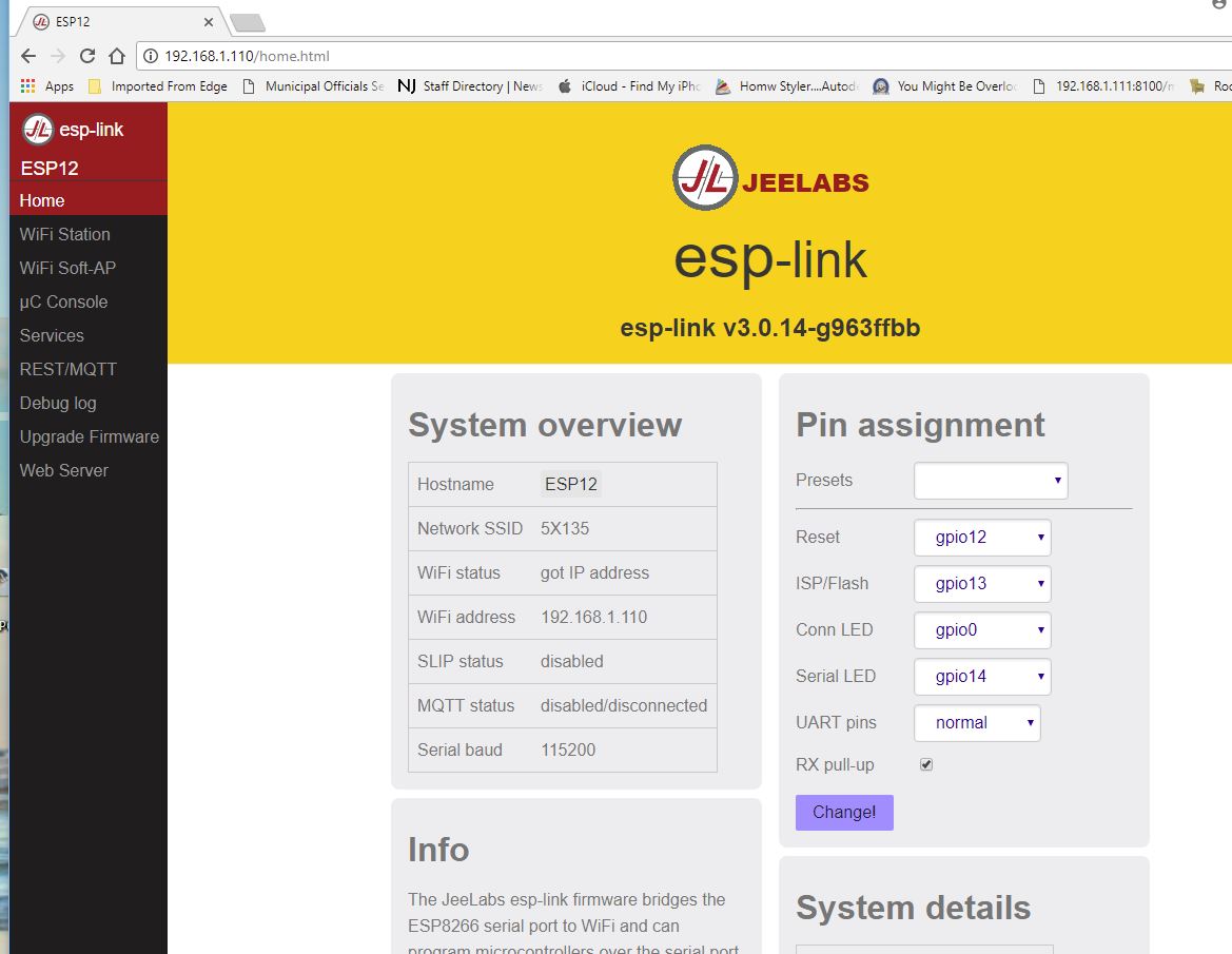

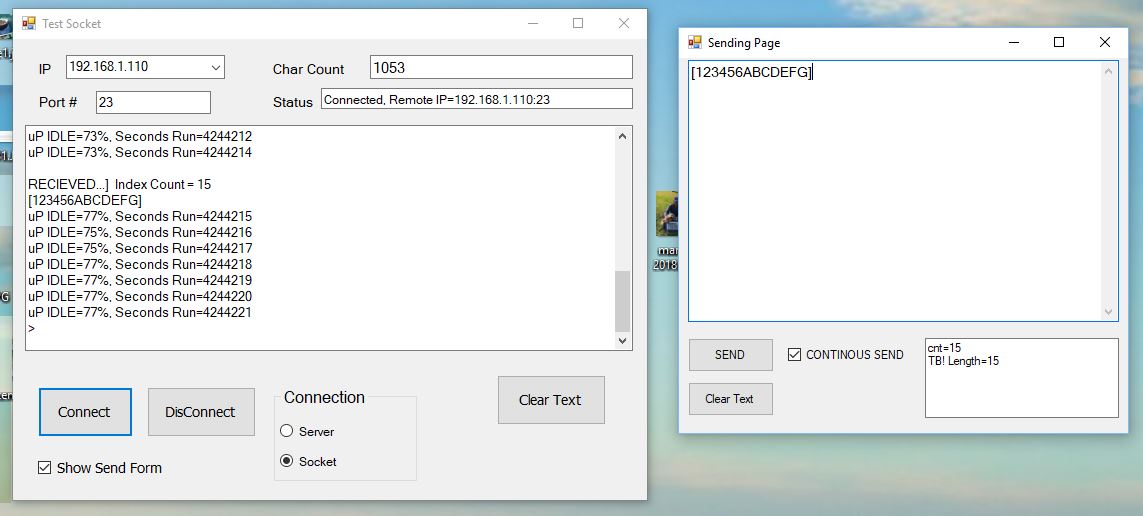

    I have set up the ESP05 and 12 serial to wifi modules (ridiculously cheap...$5, $7). Then had to program them to be "transparent bridge" so when powered up, they just act like a serial connection for send receive. And can program through web-settings to attach to your wifi network with IP and password. Pictured is a visual studio program to send and receive data to my 18F2550.
