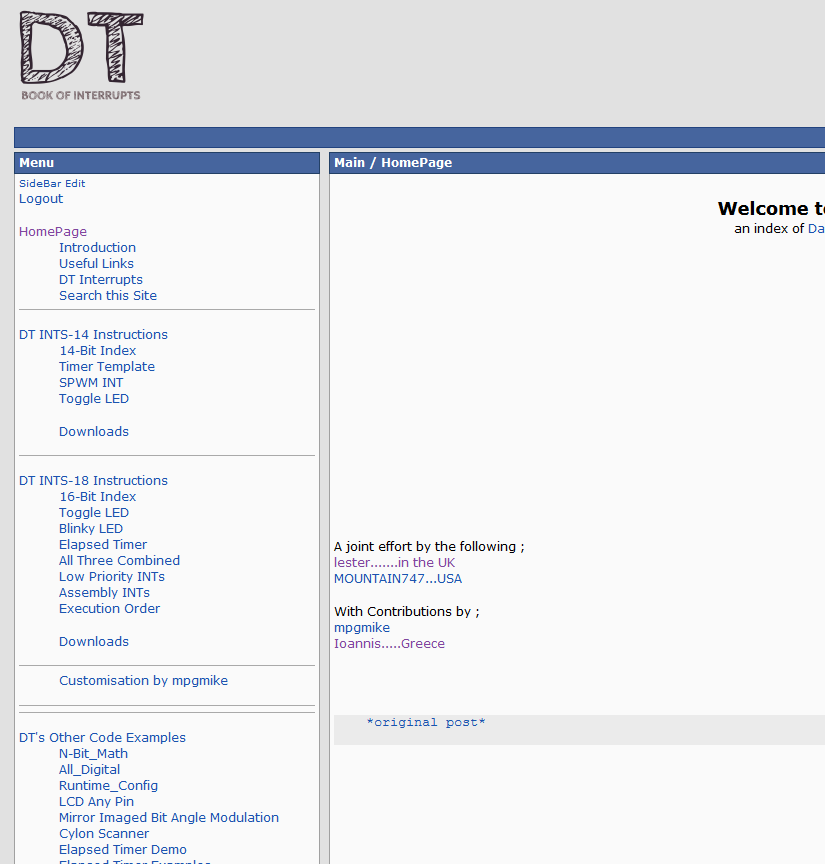

    Lester, do you have any idea why the dt.picbasic.co.uk looks like this on my Office PC Firefox?
    On the same machine but Opera shows as it should.

    YES, I think its because you tried different skins
    On opera you probably only ever used the default skin
    On your office Firefox PC , I think you viewed a different skin....as part of the discussion in the post about colour.
    Just clear your firefox browser cache and it should pick up the default skin.

    Default Re: THE BOOK of DT INTERRUPTS
    Yeap, that was it!
    Thanks Lester,
