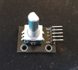

    ;This code displays a number that is incremented for clockwise rotation or decremented
    ;for counter-clockwise rotation on a 20x4 LCD. The display has two digits to the
    ;left of the decimal and three digits to the right of the decimal. Each time the
    ;shaft is pushed in, a digit is selected starting from left to right. This code
    ;could be used to display voltages that are preset by a user on a diy power supply
    ;or for Ampere presets or any of the like.
    ;The code is a bit long but it works well.
    ;Does not use interrupts.
    ;Written for use on PIC16F887 but can be modified to fit any PIC microcontroller.
    ;COULD USE SOME OPTIMIZATION!

    I have the identical rotary encoder module and use no caps at all on it,

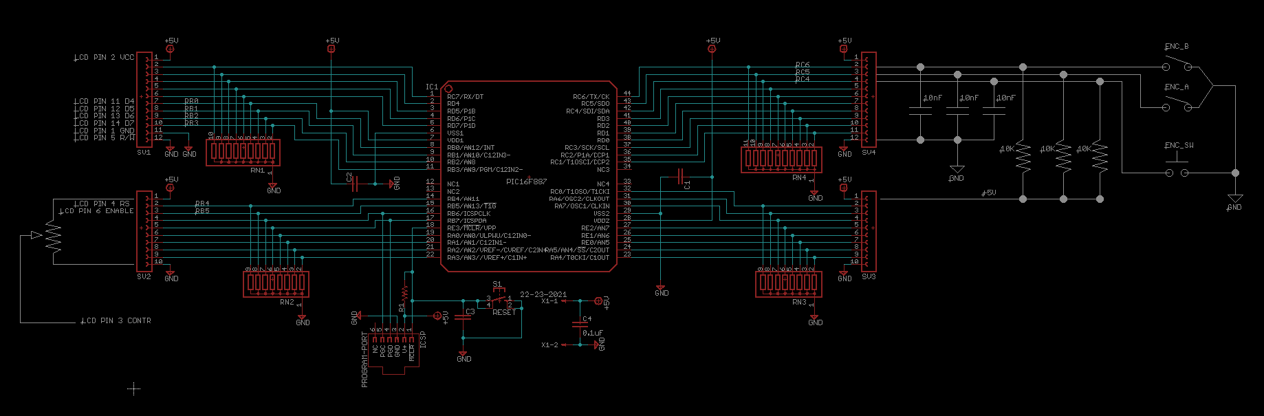

    I caught that earlier and made the changes then but it still didn't work. Here is my schematic:
    Hope its not too big. If too small, I provided an image attachment.
    I have used a pic18f458 @8mhz , a pic18f25k22 @64mhz they both work perfectly.
