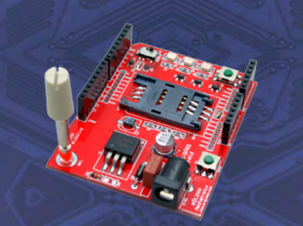

    The image that is shown below is the GSM Shield SIM900D that I used for my project. You can purchase this at http://www.e-gizmo.com/KIT/gsm shield.html for about 1,995.00 pesos.

    Features and Specifications of GSM/GPRS Shield:
    Industry proven SIMCOM SIM900D Module
    Buffered UART provides additional layer of protection
    Fused power input
    On board LDO voltage regulator
    UART/SUART switch selectable port (gizDuino)
    On board manual power switch
    SIM Card Holder

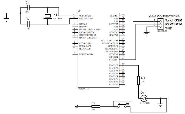

    Here is the circuit I made by integrating the PIC16F877A (datasheet:http://www.kynix.com/uploadfiles/pdf...F877A-I2fL.pdf)and the GSM Shield:

    Be sure to connect the Tx of the GSM Shield to the Tx of the PIC and the Rx of the GSM Shield to the Rx of the PIC. Take note also that the GSM needs to be powered by a 1.5A and 5VDC supply and its ground must be COMMON to the ground of the circuit.
