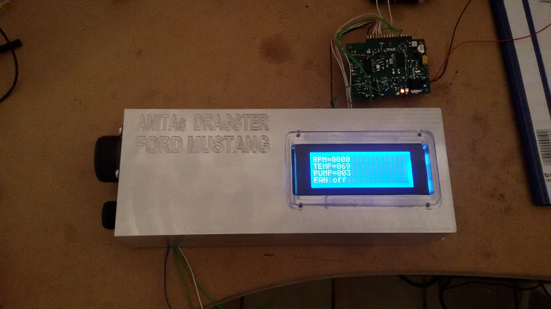

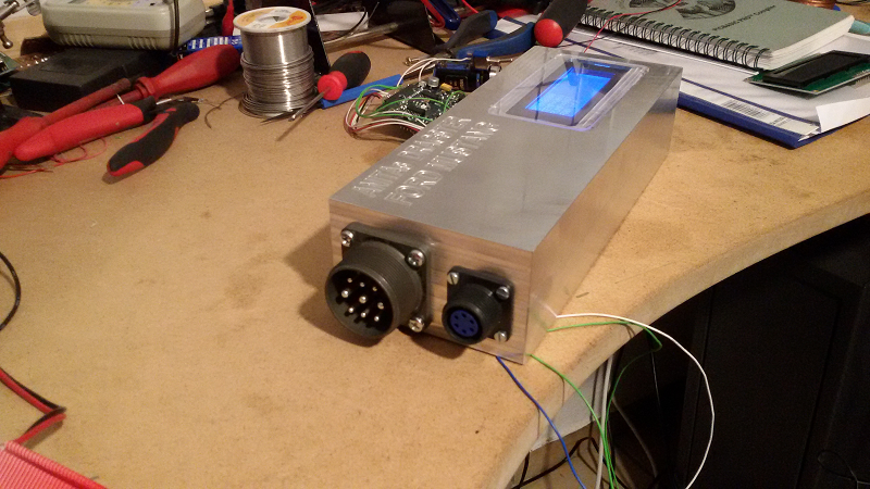

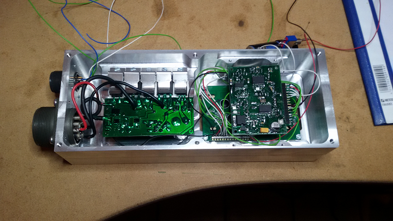

    here an example for a waterpump controller:
    https://www.tecomotive.com/en/products/tinycwa.html
    I use a "huge" billet aluminium case, a LCD and military style connectors capable of 40 AMPS.
    My problem: the communication of these two PICs and the LCD routine are slowing the 18F1320 down to
    uselessness.One mainprogram cycle may take 0.3 seconds. that 3 times more than the acceptable limit.
    Because when the engine revs up the fuel pump has to rev up too.Fast.otherwise the egine will bog.
    With Henriks help we have pinned it down the problem that the 18F1320 has to wait for the 16F88 to send
    a Character. The 16F88 has a slow routine wich slows down the 18F as well.
    So the communication between both shouldn´t disturb the 18Fs main routine. Now I have to separate
    the "count/HPWM" main routine from the "get charakters and show on LCD" routine. because the LCD routine
    can take a whole second or some more, that doesn´t matter.
    I appreciate your help.

    Here three pics of that housing and so on:Pumpcontroller1.pngPumpcontroller2.pngPumpcontroller3.png
