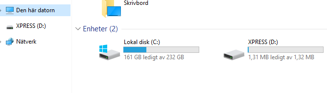

    But the cool thing is that when you plug this new board in to the PC it not only shows up as a serial port, it also shows up as a mass storage device. Here you can see it showing up as D: with a label XPRESS on my system (I appologize for the Swedish screenshot but you get the idea).

    All you need to do to program the 18F67K40 is to drag and drop your .hex file onto this device - done - and it's fast.
    We can tell MicroCodeStudio to automatically copy the file onto the device after successful compilation. To do this we need to go to View->Compile and Program Options and Add New Programmer. I labeled mine XPRESS Drag & Drop Bootloader but you can obviously call it anything you want. Since we want to do a basic file copy the Programmer Filename will be xcopy.exe and this is usually located in c:\windows\system32 but just click Find Automatically and MCSP will find it for you.
    Next is the parameters we need to pass to xcopy. I used /Y $long-hex-filename$ D:\ where the /Y tells xcopy not to ask us if we want to overwrite an existing file with the same name, the $long-hex-filename$ is the MCSP variable for the path and filename of our .hex file and D:\ is the destination path. You obviously need to match the destination path to however your system is configured, it only happened to be D:\ on my system.
