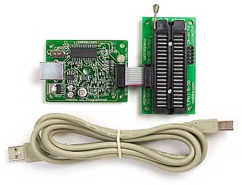

    I have both and usually use the ME Labs U2 Programmer. I use the PICKit3 for surface mount processors and haven't used the PICKit2 in several years. Not sure where I put it, actually. The U2 has a dip socket. Drop the PIC into the slot and hit Control P.

    Can't you take the ZIF socket add-on circuitboard from the U2 and just plug that into the PK2?

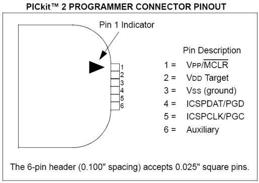

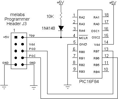

    You should be able to assemble a ribbon cable from the Pickit2
    to the U2 ZIF socket PCB
    Name:  U2 icsp.schematic.jpg
    That's what I did except in reverse; a ribbon cable from my U2 to prototype boards, bypassing the ZIF.
    Work's great!
