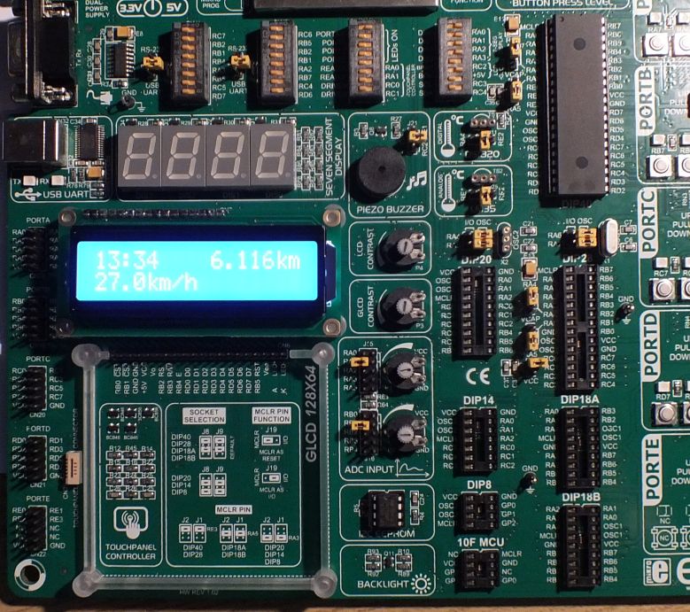

    I've written some code targeting the 18F1320, I thought I had a couple of those in stock and I just set out to build up a test circuit to verify the code but it was the 18F1330 I had and as it turns out it's a completely different beast (lacking a TMR2 which the code relies on for example).
    I guess I could change the code to suit a device that I do have but then that might not be what you intend to run it on anyway and we'd still need some back and forth so I'll just post the code as is and ask you to kindly remember that it is untested. Hopefully though it serves its purpose and show you the overall idea of one way that this can be done without external RTC chips or interrupts.
    There is a bit of code but I tried to make it as complete as I could for a first pass, I'm sure there are things I didn't think of though.
    Feel free to pick it apart, ask questions why this or that.

    I've played around with the code a bit, got it up and running on my EasyPIC7 development board using a 18F45K22 device. It counts, it times, it calculates and it displays (during and after measurement).
    The code I post here are what's running on my device, if you plan to use another device you must:

    ANSELB = 0
    ANSELC = 0
    ANSELD = 0
    ANSELE = 0
    TRISA  = %11111000                      ' Status LEDs on RC0-RC2
    LATA   = %00000000
    TRISB  = %01000000                      ' LCD on RB0-RB5, Start/Stop on RB6
    LATB   = %00000000                      ' All pins low
    'OSCCON = %01110010                      ' For 18F1320, Internal oscillator, 8MHz
    'T1CON  = %00000010                      ' For 18F1320, External clock on RB6, timer OFF for now.
    T1CON = %10000000                       ' For 18F45K22
    T2CON  = %00000010                      ' 1:16 prescaler, TMR2 off for now
    PR2    = 249                            ' T2 interrupt flag set every 250*16 tick
    PAUSE 500
    Start:
        State = Idle
        ReadyIndicator = 1
        RunIndicator = 0
        ErrorIndicator = 0
        LCDOUT $FE, 1,   "     Ready"
        LCDOUT $FE, $C0, "Press start/stop"
        Select CASE State
            Case Idle
                If StartStopButton = 0 THEN             ' If the button is pressed we
                    'LCDOUT $FE, 1                       ' Clear the screen
                    Hours = 0
                    Minutes = 0
                    Seconds = 0
                    ms = 0
                    TMR1H = 0                           ' reset the pulse count
                    TMR1L = 0
                    TMR2 = 0                            ' reset the timebase
                    TMR1IF = 0                          ' clear the overflow flag
                    TMR2IF = 0                          ' clear the timebase tick flag
                    TMR1ON = 1                          ' enable the counter to count pulses from the driveshaft
                    TMR2ON = 1                          ' enable the 2ms timer tick
                    ReadyIndicator = 0                  ' update status LEDs
                    RunIndicator = 1
                    ErrorIndicator = 0
                    TimeOverflow = 0                    ' clear overflow flag
                    State = Starting                    ' and move to the next state.
            CASE Starting
                IF TMR2IF THEN                          ' TMR2IF gets set every 2ms
                    TMR2IF = 0                          ' reset flag
                    GOSUB Update                        ' update our time registers
                    ' Wait for the button to be released before transitioning to the next state.
                    If StartStopButton = 1 THEN         ' Button released?
                        DebounceCount = DebounceCount + 1
                        DebounceCount = 0               ' Button must be released 10 ticks in a row.
                    IF DebounceCount = 9 THEN           ' Button has been released for 10 ticks
                        DebounceCount = 0
                        State = Counting                ' Transition to next state.
            Case Counting
                IF TMR2IF THEN                          ' 2ms tick?
                    TMR2IF = 0                          ' clear flag and
                    If StartStopButton = 0 THEN         ' Button pressed?
                        RunIndicator = 0
                        TMR1ON = 0                      ' Disable pulse counter
                        TMR2ON = 0                      ' Disable timer
                        State = Stopping
                 IF TMR1IF THEN                         ' Pulse counter overflow
                    TMR2ON = 0                          ' Disable timebase
                    RunIndicator = 0
                    ErrorIndicator = 1
                    State = Error
                 ' Here we can do anything else that needs doing while the
                 ' system is counting but it's very important that it does
                 ' not take longer than 2ms or we will lose time.
            CASE Stopping
                ' Wait for the button to released before transitioning to the next state,
                If StartStopButton = 1 THEN             ' Is button released?
                    DebounceCount = 0
                IF DebounceCount = 10 THEN              ' Button released for duration of debounde time?
                    DebounceCount = 0
                    State = Done                        ' Transition to next state.
                ' The timer is no longer running so we pause here for the same duration.
                PAUSE 2
            CASE Done
                ' This is where we perform the calculations and present the result.
                ' Each count from the driveshaft equals 0.6m of car movement.
                ' Lets say the pulse count is 12345 and the seconds count is 503.
                ' We've traveled 12345*0.6=7407 metres in 503 seconds, 7407/503*3.6=53.0km/h
                ' Using the ** operator allows us to effectively multiply by fractions of 65535 so:
                ' 12345 ** 39322 = 7407
                ' 7407 * 36 = 266652
                ' 266652 / 503 = 530 which we interpret as 53.0km/h
                ' 53203 pulses in 1412 seconds,
                ' 53203*0.6/1412*3.6=81.39km/h:
                ' 53202 ** 39322 = 31922
                ' 31922 * 36 = 1149192
                ' 1149192 / 1412 = 813 which we interpret as 81.3km/h
                Distance.HIGHBYTE = TMR1H
                Distance.lowbyte = TMR1L
                Distance = Distance ** 39322        ' Multiply by 0.6, Distance is now in metres
                Temp = Distance * 36
                AverageSpeed = DIV32 Seconds        ' 215 for 21.5km/h
                LCDOUT $FE, 1, DEC Distance/1000, ".", DEC3 Distance//1000, "km in ", DEC2 Minutes, ":", DEC2 Seconds
                LCDOUT $FE, $C0, "Speed: ", DEC AverageSpeed/10,".", DEC AverageSpeed//10, "km/h"
                ReadyIndicator = 1
                State = Idle
            CASE Error
                If TMR1IF THEN                      ' Interrupt flag is set if counter has rolled over
                    LCDOUT $FE, 1, "ERROR Pulse cnt"
                IF TimeOverflow THEN                ' Flag set if seconds variable has rolled over
                    LCDOUT $FE, 1, "ERROR Timer"
                LCDOUT $FE, $C0, "Restart to clear"
                State = Idle
        END SELECT
    Goto Main
    '-------------------------------------- Subroutines ------------------------------------------------
    Update:
        ' Our timebase is 500Hz.
        ms = ms + 2
        If ms = 1000 then
            ms = 0
            seconds = seconds + 1
            IF Seconds // 60 = 0 THEN
                Minutes = Minutes + 1
                IF Minutes = 60 THEN
                    Minutes = 0
                    Hours = Hours + 1
            UpdateDisplay = 1                   ' We're triggering a display update every second
            ' We're using DIV32 to calculate the average speed. It does not allow the divisor
            ' to be larger than 32767 (which is 9 hours and some minutes so it should be fine)
            ' but since we're good programmers we're going to check for it anyway.
            If Seconds > 32767 THEN
                TimeOverflow = 1
                RunIndicator = 0
                ErrorIndicator = 1
                State = Error
        ' Since we have a 2ms time tick and we're polling the that tick with software
        ' we can not allow ourselves to spend too much time doing anything else.
        ' For this reason we've divided the while display update process in sections
        ' so we do it little by little while still going back checking the timer tick
        ' so that we don't lose track of time.
        IF UpdateDisplay THEN
            Select Case LCDSequence
                Case 1
                    LCDOUT $FE, 128             ' Cursor at first character, first line
                CASE 2
                    LCDOUT DEC2 Minutes, ":"
                CASE 3
                    LCDOUT DEC2 Seconds//60
                CASE 4
                    LCDOUT "   "
                    IF Distance < 10000 THEN
                        LCDOUT " "
                CASE 5
                    LCDOUT DEC Distance/1000, ".", DEC3 Distance//1000
                CASE 6
                    LCDOUT "km  "
                CASE 7
                    LCDOUT $FE, $C0             ' Cursor at second line
                CASE 8
                    LCDOUT DEC AverageSpeed/10,".", DEC AverageSpeed//10, "km/h  "
                CASE 9
                    LCDOUT "       "
            END SELECT
            LCDSequence = LCDSequence + 1
            IF LCDSequence = 10 THEN
                LCDSequence = 0
                UpdateDisplay = 0
