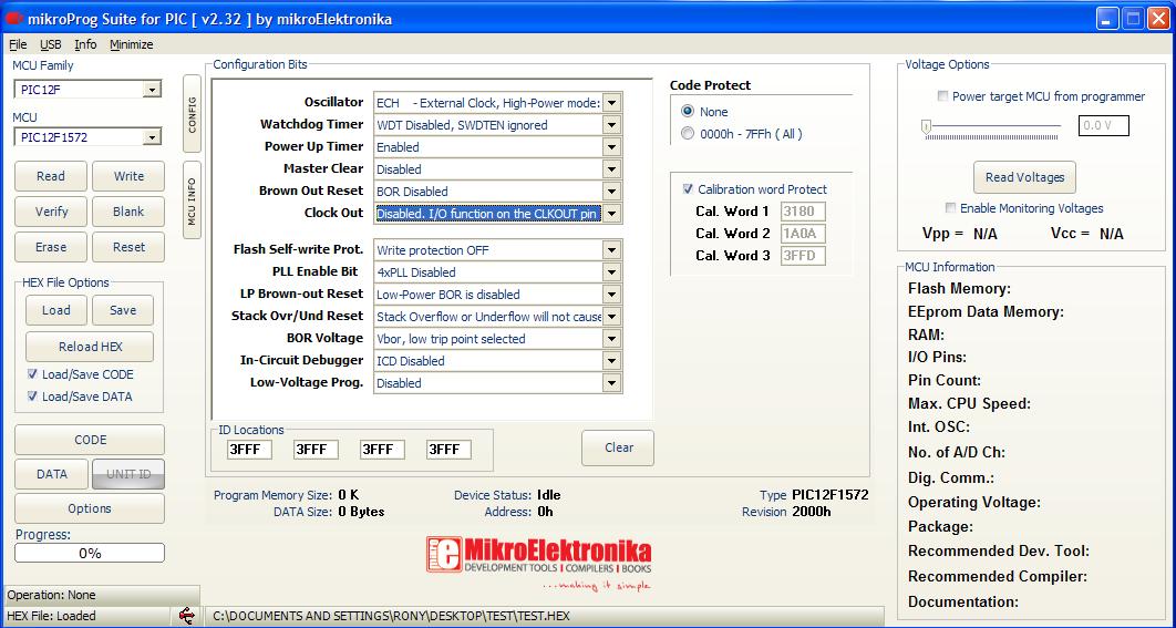

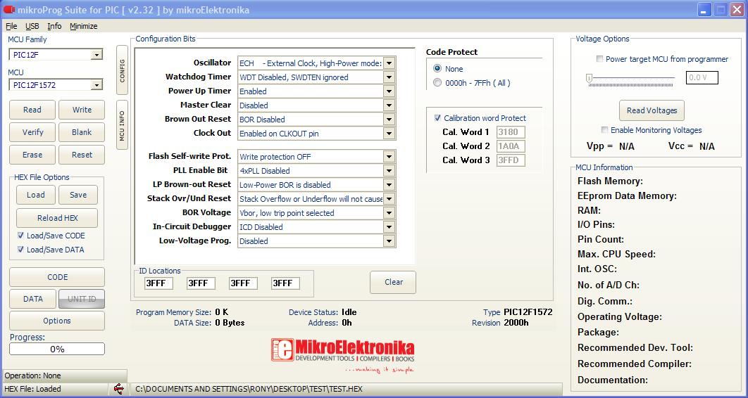

    I got the PIC12F1572 and compile it with the PBP3.0.4.0
    It runs properly when using INTRC, but with external oscillator it doesn't...
    Although i set necessary configuration (ECH, Clock out pin ...) but still not working.
    Note that i am just blinking an LED in the test.
    Well, show us the necessary configuration then and tell us what type of external oscialltor you're actually using and how it's connected. Without that we can only guess.

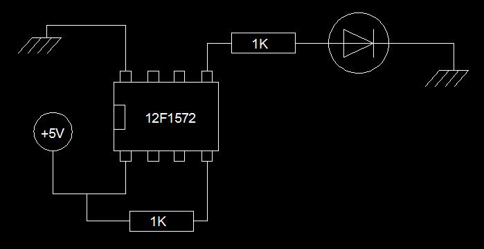

Size:  111.4 KBName:  12F1572_Schematic.JPG
    Attached relative pictures
    Feb 2007
    33
    Default Re: 12f1572

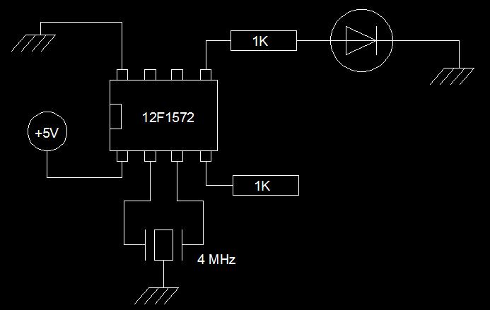

    sorry i forget the resonator
    I will put it now
    Feb 2007
    33
    Default Re: 12f1572
    Resonator added to the schematic

    OK, with a resonator I don't think you can have CLKOUT enabled.

    The other option is I/O function which is not the case, anyway i just tested it and didn't function.

    You're right, it can't be I/O -but it can't be CLKOUT either....
    I may be wrong but it looks to me as if the 12F1572 can not run directly on a crystal or resonator but rather depends on an external oscillator "module". I suggest you read the oscillator section of the datasheet and see if you agree.
    Feb 2007
    33
    Default Re: 12f1572
    I think you're right, i was reading it now and found out that this PIC is not suitable for oscillator or resonator, it should be used by either internal clock or external clock.
