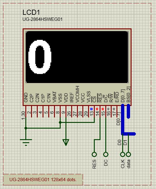

    but it doesn't start at row 49... Always at ROW 0 !
    I tried to see code from others (arduino too but they use libraries so... just crazy) but I can't see what's wrong.
    Any help ?
    Sep 2005
    France
    50
    Default Re: SSD1306 start display problem
    OK... I know what's wrong. This is not my code ! It's because of the bad simulation of the SSD1306 with proteus software :-( I took a real 0.96" OLED display and it works fine without any change of my code.
