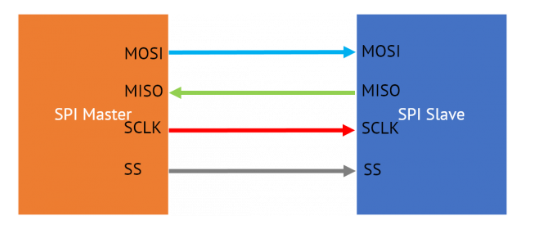

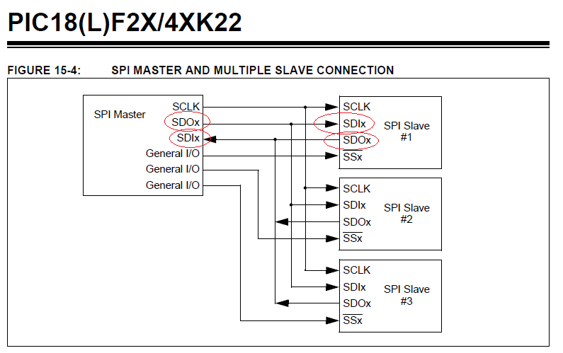

    Default Re: Programming RFM radio modules in Basic
    I'm confused about the SPI connection.
    In the manual of the PIC18F26K22 this is how do they have it Master and Slave.
    The MOSI from Master goes to MISO on slave and the MISO from master goes to MOSI on slave. Which it seems for me to be the right connection.
    But everywhere else on the NET i find it as following. MISO on Master goes to MISO on slave and MOSI on Master goes to MOSI on slave.
    https://www.google.gr/search?q=spi+c...w=1422&bih=701
    sdo is pic output and would be the mosi line [master out slave In] connect to the module input pin, should be marked mosi
    sdi is pic input and is the miso line [master in slave out ] connect to the module ouput pin, should be marked miso
    Oct 2010
    413
    Perfect thanks for the explanation. It is clear.

    Hi Richard, thanks for replying again. I understand you have more important things to do than to explain to me the basics.
    Regarding the comments on the program, i leave them there for me. Sorry for disturbing your reading by using those comments. Because of i use them for my children project GPS, i try to keep those to remind me what i have done.
    Now i have some questions, based on your code.
    "for correct spi tx to rfm69 CKE must be asserted"
    Ok that i will set, but still i do not understand "SPI Clock Edge Select bit" does inside the code?
    Does it gives the "OK" when it is "1" Transmit occurs on transition from active to Idle clock state
    which means that the data transmitted on the falling edge of SCK?
    is a particularly dangerous idea when dealing with devices that have a chip select low input
