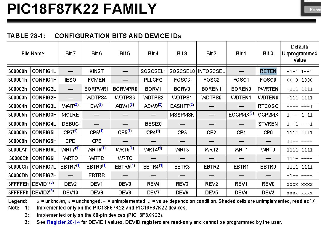

    Hi Guys ,
    as per normal when i am implementing a new cpu , i refer to the INFO file for its config, then go through the datasheet to see what it setting or not as dephalt
    The setting for CONFIG7L in the datasheet shows it is EBTR0 - EBTR7 ( TABLE 28-1 ) spelling
    and CONFIG7H in datasheet shows EBTRB spelling
    when looking at the INFO file for both 18f67k22 , 18f87k22 it shows "CONFIG EBRT0- EBRT7 = OFF " , "EBRTB = OFF"
    When doing a compile the INFO file is correct in what PBP expects it as EBRT0-7 , EBRTB , , but its clearly not the same name spelling as the datasheet it is setting the bits config for
    i have not checked if these setting actually protect the read block as yet on the chip
    it is now an typo error that PBP now expects and now must use for now or perhaps the datasheet got it wrong ,( i but doubt it)
    cheers
    Sheldon

    3,185
    Default Re: Pbp3 - pic18f87k22 / pic18f67k22 setting config typo error ???
    If you look at the MPASM .inc file (ie p18f87k22.inc) where all these settings are defined you'll find that it is called EBRT so the .INFO file matches what the assembler expects. I don't know which is "correct", the datasheet or the .inc file.
    Feb 2012
    PERTH AUSTRALIA
    738
    looking at other info files / other configs i have for 18F chips which use the datasheet ref of EBTR1 -4 ( 18f46k80 )
    it seems PBP has done it only for the 18f67k22, 18f87k22 chips , which seems like its typo that PBP has just incorporated for these chips in the compile
    3,185
    If anything it's a typo in the MPASM .inc file for the device and PBP needs to follow that in order for it to work.
    Feb 2012
    PERTH AUSTRALIA
    738
    yes , just the way its is for these 2 chips , its seems to get the right data in the hex for the programmer config
