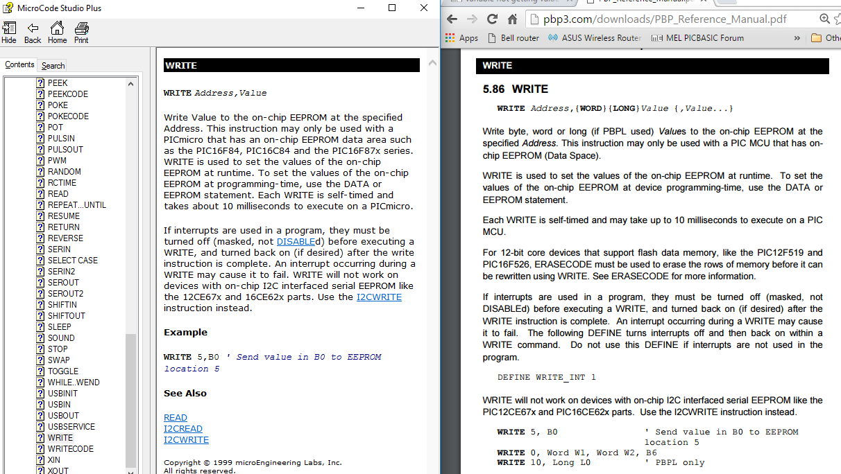

    i was not aware of the write command to do words, its not in the online help file for the instruction , that i can see
    3,521
    Default Re: Variable not getting value from array...?
    The help file in MicroCodeStudio was generated years ago and has, as far as I can see, not (ever?) been updated. You really should refer to the .pdf manual instead.
    Feb 2012
    PERTH AUSTRALIA
    838
    yep your right hedrik , you think by now they would have done an update on the online ver though
    Jan 2005
    Montreal, Quebec, Canada
    2,597
    I would have expected an updated online help file when I paid for MCSP v5 along with PBP v3.
    Name:  WRITE statement.png
    3,521
    Yeah, that would be nice (and shouldn't be hard to do) but I'd rather have them look into the issue with the damn thing (mcsp) crashing randomly. But, nope, not happening...
    Problem, as I see it, (but I'm speculating and can obviously be wrong) is that the IDE is written by a third party (Mecanique) so Melabs has no "control" over it and would have to contract Mecanique to do work on it. Finding and fixing the crashing issue is hard because it apparently only happens to people outside of MeLabs and Mecanique. Well, it happened to Darrel too but that's not going to help us now :-(
