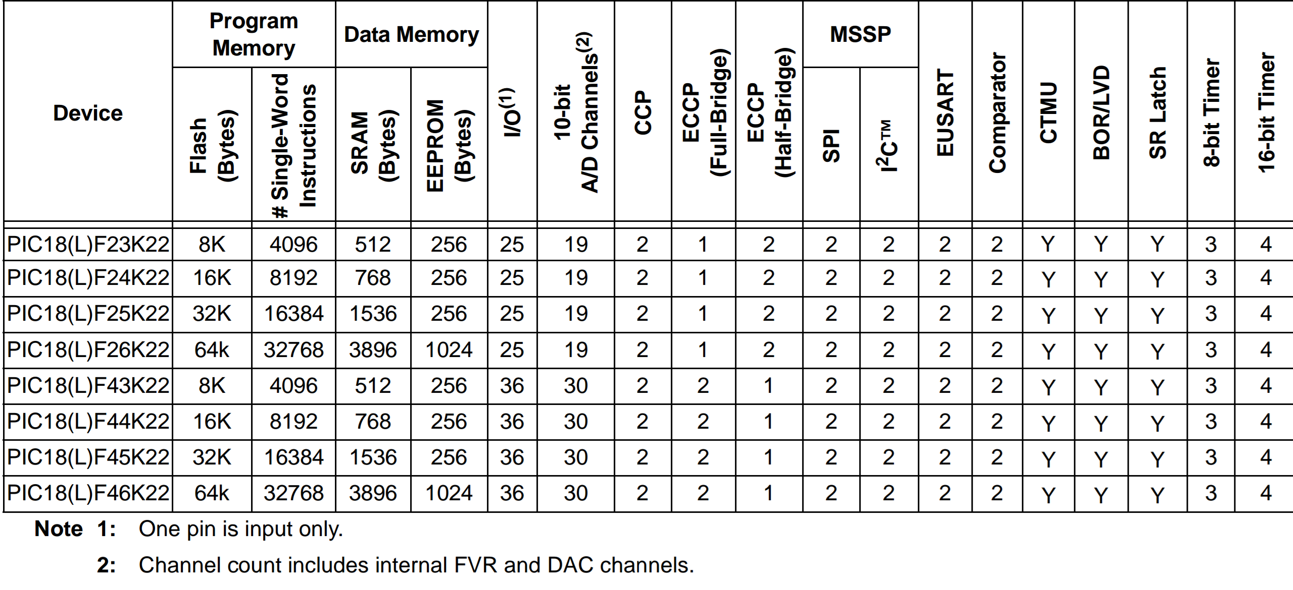

    Default Re: Getting back into the PBP saddle after a long absence
    Oh yeah, these puppies can run up to 64 MHz.
