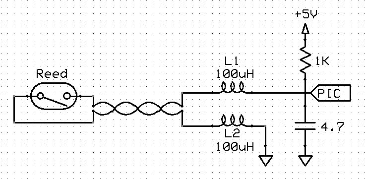

    Like the guys said, a stiff pullup and a cap. I would also add an inductor to keep the noise spikes out.
    You can probably get by without L2 in this diagram but added it in just in case.

    Thanks for the great circuit sketch! I don't have any inductors on hand but if this works well, I would consider making a module of it for future uses of the reed switch as a sensor.

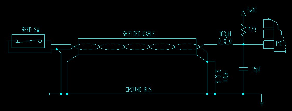

    I have an application question and to help explain it I have attached a schematic of my board. My traces on the etched board follow the lines on the schematic literally. You will observe that at PIC pins C4-C6 my three sensors are pulled up with 4.7k resistors to 5vDC. At the same connector I have a ground pin which further down the line combines the 3 grounds from the switches.
    My question is: Would it be good or bad practice to place the inductors further away outside the controller enclosure say under the table? This would necessitate for each of the 3 signal wires a length of lead wire maybe 6-12 inches away from the board itself (am I just creating another albeit shorter antenna?) The control enclosure is already pretty filled with stuff but maybe I could still fasten a daughter-board to take care of this function. I would really hate to redesign and rebuild my present main board yet again to integrate the inductors.
    Lastly since I am new to working with inductors could you spec or describe what I would be looking for number-wise from say the Digi-Key online catalog?

    I'm not sure about the current required for the "run/stop, direction and turnout relays" but I notice you are sourcing the current instead of sinking it thru the PIC. That's bad design to me as most mosfet's even in the case of internal fet's in the PIC can sink more current than source. I would ideally use a NPN transistor for the relay drive circuits and feed them as a separate supply connection to the board where the power enters. I would also place a 10uF cap at the PIC pin's 19 & 20 along with the 100nF cap you already have. I also notice you have NO cap's for the display power circuits. I agree with Henrick that the ideal interface method is for optoIsolators on the inputs from the reed switches. If the wiring is run along side the track and the engine is running there is quite a bit of coupled energy into the inputs of the PIC as the engine is probably driven by a DC Brushed motor as well as the wheels making and breaking the circuit.

    Hi abecker,
    The inductors should be in your controller circuit because just as your intuition suggests, you will end up with a short antenna at the input of your box.
    If you have room at the reed switch connector, these inductors can be installed at the molex connector you have there by soldering each one inline with the wire going to the switch and the other side crimped to the connector pin. Be sure to shrink tube each one to keep from shorting to its neighbor.
    And it looks like you can put your filter caps at each (R1 pullup resistor and PIC input) to the nearest GND.

    LinkM,
    I appreciate your idea to inline the inductors and naturally shrink-tube saves the day for so many inline solutions like this.
    I did strike upon the idea of soldering the caps to the traces under the board because the board is on standoffs anyway.
    By the way in my searching the net for use of inductors and caps for noise filtering, I discovered some LC filter arrays in a single IC type package with 4 per chip, by TDK (series MEA) but it looked like they were narrowly designed and spec'd. for telecom use. Not understanding enough about LC filters I didn't know if the product series could have helped my situation. It was a very slick idea though having 4 filters on the chip. If that worked, it would be nice to put that on the main board in any new design I might come up with in the future.
    Thanks for all your help.

    I am posting this reply to my first inquiry for those in the future who are merely browsing may want to know the results without going down through the many threads in detail. Having said that I would encourage any person who needs to solve a similar problem to dig down through (the threads of) this exchange of great ideas and suggestions.
    I am happy to report that my false triggering problem has been solved no doubt to a combination of systems suggested here. I will summarize what I did for others to consider.
    - I added bypass caps to all power supply traces across the +5 & Gnd.
    - I installed a common ground bus connected to the house power earth ground.
    - Since I am using a wall-type 5vDC power supply without a ground and a plastic enclosure, I grounded my main control board to the bus.
    - I used a shielded cable between the reed switches and the control enclosure and connected the shield to the ground bus(see attached schematic.)
    - I added bypass caps to each of the 3 reed switch signal lines.
    - I decreased my pull-up resistor values on the signal lines from 4700ohms to 47ohms
    - I have not yet received my inductors but have etched a small carrier board (no room left on the main board) to connect them as shown.
    I have not needed to put in place the software-based solutions but they are very interesting and may find their way into future work.
    Once again I thank all who contributed to this discussion. There are many new details for me to apply to the next project.

    It would be interesting if you could do one of the above solutions at a time and narrow it down to which one or combination of the several solved it.
    The 100uH coil going to ground isn't doing anything and could be deleted. I'd suggest only having one ground for the reed switch and shield preferably as close to the PIC as possible.
    Did you choose the cap and the coil values for any particular reason? I'm assuming you're using a PWM controller and wonder if you could tune them closer to your PWM frequency to reduce spurious noise further. Usually I have many caps laying around and only a few coils so reducing your cap size would be the easiest.
