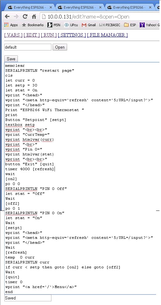

    below is my setup... and a very AMAZINGLY simple program that is very powerful. (Not written by me, just the provided example code with pin numbers changed to match the -01 module)

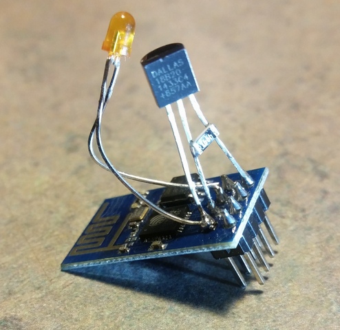

    It is a full blown thermostat! using an ds18b20 and an LED (with integral current limiting resistor) to represent ON/OFF of the thermostat.
    If you really like BASIC (or, like me, can only really only write code in BASIC) then you really owe it to your self to give it a go. Well and also want to bring in WiFi to your projects.
    Since the IDE is completely implemented within the module itself and accessed from a webpage then what could be more simple?
    In the image below showing my ESP8266-01 module take note of the pull-up 5K resistor soldered between the data and +V pin (and as noted earlier the LED has a built in current limit resistor)

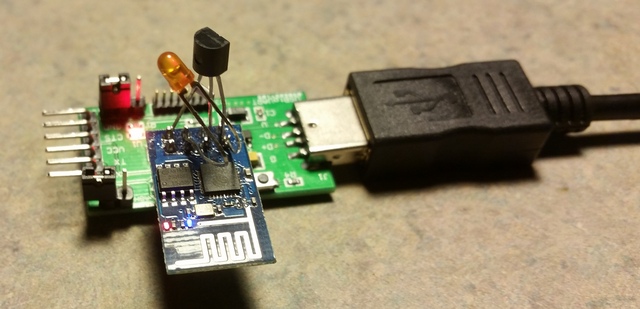

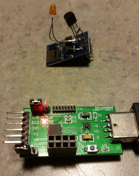

    I highly recommend the USB ftdi module in the picture as it has built in 3.3v regulation and is extremely easy to use.
    you can get one here http://www.ebay.com/itm/CP2102-USB-T...QAAOSwBahVAS39

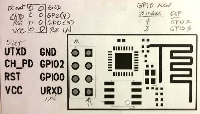

    Sorry for the bad handwriting...

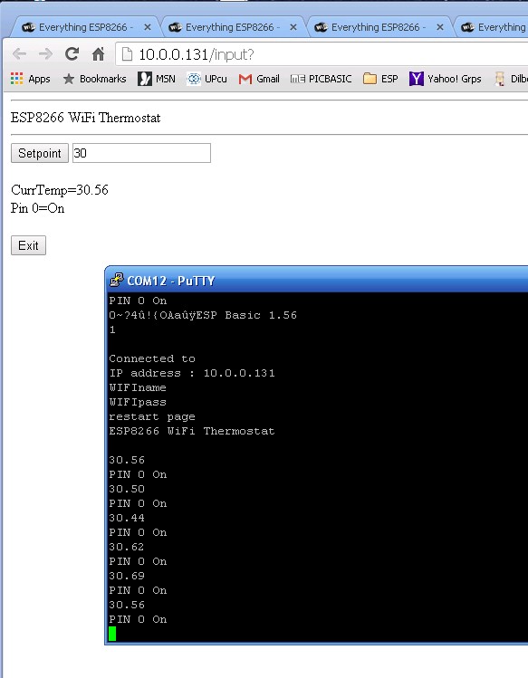

    In this picture the module is mounted on the USB ftdi interface and communicating both serially to putty terminal and via wifi to my pc's web browser!

    this photo shows the putty serial terminal window and the output from the module as well as the webpage from the module itself showing the values and temperature setpoint.
