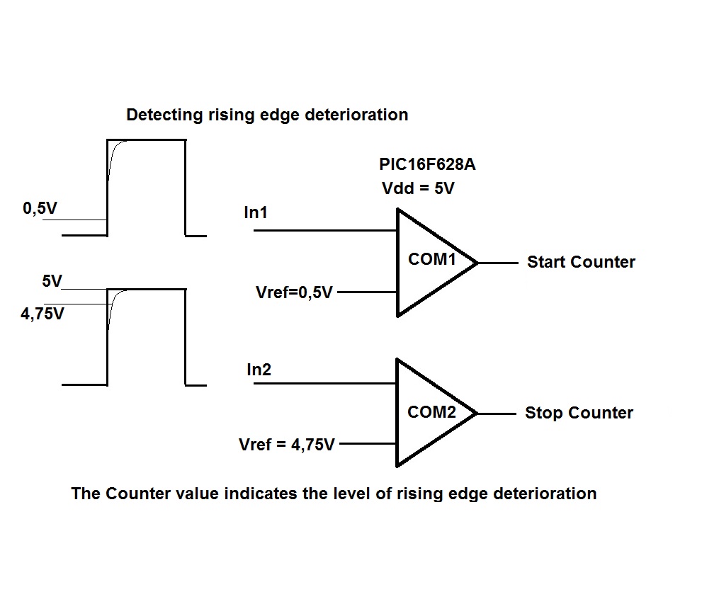

    Name:  Comparator in action.jpg
Size:  84.7 KBHi Henrik
    Thank you very much on your kind reply.
    First – I am new in PBP programing and PIC use.
    Here is what I am trying to work out.
    I shold like to measure or detect the rising edge deterioration on square vawe signal.
    First compartor is put On by low threshold voltage of 0,5V.The output of first comparator starts counter.
    Second comparator is put On by high threshold level of 4,75V where edge deterioration is expected..Ther output of second comparator stop counter.
    The counter value detect the level of rising edge deterioration.
    First – is it idea about edge detecting OK?
    Or anyone has better solution?
    If idea is OK the Questions are:
    How to set threshold level for COM1 and COM2 externaly.Is it enough only to make resistor network (as at OPM amplifiers) or Comparators have to be additionaly adjusted by code?
    How to enable bouth comparators in PIC ?
    Information about how to set appropriate registers should be of the great help.
    Default Re: Analog comparator in action
    I guess the general idea is OK but whether or not a PIC can be used depends on the nominal risetime of the squareware and the resoulution you expect to get out of the measurement. The software overhead involved with using interrupts and starting/stopping the timer will most likely kill it but without any numbers on what a good and bad risetime actually is it's hard to say.
    Another option could be to design a window comparator so that its output is HIGH only when the voltage is between 0.5 and 4.75V. The output then drives the TMR1Gate input (on a device that has one of course). This will most likely work "better" than the comparator/software/timer aproach but again it depends on how fast/slow and godd/bad rise time actually is. Are we talking ns or ms?
    Since you neglected to answer my question I'll ask again: What IS the typical value for a "good" risetime?
    Hi Henrik
    have just measured rise time - it is 2,5uSec (0 to 5 V positive edge) - with no distorsion on positive egde.
    signal under consideration - Quadrature signal, frequency = 30 KHz.
    Thank you.
    Mike
    OK, so assuming a completely linear risetime (which most likely isn't the case but anyway) it'll be 2.125us from 0.5V to 4.75V.
    If you run the PIC at 20MHz the timer will have a resolution of 200ns so you'll get a reading of around around 10 for a "good" pulse (provided the window comparator is fast enough). If you get a PIC capable of 32MHz, 40MHz or even 64MHz the resolution will of course increase.
