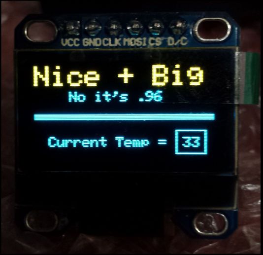

    Default Re: SSD1306 Include example
    This is a newer version that can use either I2C or SPI. Also a minor improvement to SSD_Clear. Interface handling a little better. Still well under 4K flash. SPI is faster of course. The warnings above about SSD_INIT still apply. This version is using #IFDEF's of V3 so if you are using V2.6 just take out the I2C or SPI code that you don't need.
    TimC
    First a Sample of how to use the Include:
    'SSD 1306 Sample July 20 2015
    DEFINE OSC 20
    ADCON0=0
    ADCON1=7
    '=======================    Include Configuration    ==========================
    #DEFINE USE_I2C			' Only one Connection allowed  USE_I2C or USE_SPI
    SCL var PortC.3         ' I2C Clock
    SDA var PortC.4         ' I2C Data
    '#DEFINE USE_SPI		' Only one Connection allowed  USE_I2C or USE_SPI
    'SSD_DC VAR PORTD.1 	' SPI D/C pin		you will need to set TRIS
    'SSD_SELECT VAR PORTD.0 ' SPI CS pin		you will need to set TRIS

    Include "SSD1306m.inc"  ' bring it in
    '==========================    MAIN  Routine    ==============================
    temp var byte
    gosub SSD_Init
    looper:
    arraywrite SSD_BUFF,[0,0,"Line 0",0] : gosub SSD_PRINTXY
    arraywrite SSD_BUFF,[" and more",0] : gosub SSD_PRINT	' continue on same line
    arraywrite SSD_BUFF,[30,1,"Middle 1",0] : gosub SSD_PRINTXY
    arraywrite SSD_BUFF,[10,2,"Here we are Line 2",0] : gosub SSD_PRINTXY
    random temp		' jumps about
    arraywrite SSD_BUFF,[0,3,"Current Temp=",dec2 temp, "deg" ,0] : gosub SSD_PRINTXY
    arraywrite SSD_BUFF,[20,5,"Hip Hop Hi Ho 5",0] : gosub SSD_PRINTXY
    arraywrite SSD_BUFF,[10,6,"|%+-./\<=>_     6",0] : gosub SSD_PRINTXY
    arraywrite SSD_BUFF,[10,7,"{}[]!@#$%^&*()  7",0] : gosub SSD_PRINTXY
    sleep 1
    GOTO looper

    Apr 2013
    32
    Hello TimC,
    I was trying to create a second char table with your include file which is double sized fonts. I used page mode and double lines to create fonts (maybe using horizontal mode was better but I believe that the best way is the way you know).
    So I modified your include file a bit. But the thing is I wasn't able to understand your table logic so I couldn't create a table like yours and so I added my table style for bigger fonts.
    Since my char codes take much place, I only added numbers here, if you could explain or show me how to convert these to table like yours that would be great
    I want to explain changes I made first;
    To use big fonts, arraywrite SSD_BUFF,[column,row,"string" or decx number or variable,0] : gosub SSD_PRINTXY_Big
    I created and divided fonts from half, upper side first row, lower side next row, SSD_PRINTXY_Big takes SSD_BUFF contents and prints upper half to first row and then goes back of SSD_BUFF and again prins lower half of chars to next row.
    It is working as it is but need some more improvement =)
    Here is your modified inc file

    I was able to get the Double size text to work. Also lines. Still fits in 4K but I had to give up PIC16's because of the 256 byte restriction on the lookup table.
    Tested the code on more displays both .96 and 1.3". The SH1106 works as well. There are now 2 types of Clear and Go to XY. If one does not work try the other.
    Making a Box takes some work since joining the corners is not that easy.
    I'm sending a Pic on the next post.
    Enjoy
    TimC
    temper var byte
    gosub SSD_Init
    looper:
    arraywrite SSD_BUFF,[0,0,"Nice + Big",0] : gosub SSD_PrintXYDouble
    arraywrite SSD_BUFF,[25,2,"No it's .96",0] : gosub SSD_PRINTXY
    arraywrite SSD_BUFF,[0,4,125,$0F] : gosub SSD_PRINThLine 'colstart,row,length,pattern			Big fat line
    arraywrite SSD_BUFF,[100,5,20,$08] : gosub SSD_PRINThLine 'colstart,row,length,pattern			top of Box
    arraywrite SSD_BUFF,[100,7,20,$08] : gosub SSD_PRINThLine 'colstart,row,length,pattern          bottom
    arraywrite SSD_BUFF,[100,5,5,17] : gosub SSD_PRINTvLine 'col,row,Starting Height,total length	Left Side
    arraywrite SSD_BUFF,[120,5,5,17] : gosub SSD_PRINTvLine 'col,row,Starting Height,total length	Right Side
    random temper		' jumps about
    arraywrite SSD_BUFF,[10,6,"Current Temp =",0] : gosub SSD_PRINTXY								'label
    arraywrite SSD_BUFF,[105,6,dec2 temper,0] : gosub SSD_PRINTXY									'value in box
    sleep 1
    GOTO looper

    Here is a pic of the output:
    Name:  96 Display.jpg
