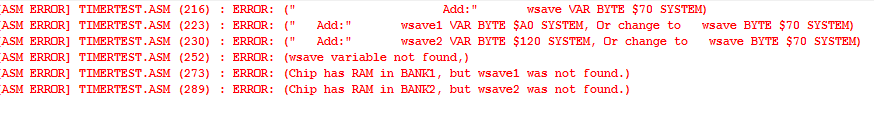

    When compiling the Blinky code I get these ASM errors, using PBP3 (MPLABX IDE) with PIC16f628. Any ideas on the errors?

    Default Re: LED Blinking while main does something else
    as the error message suggests , add these lines to your code
    wsave VAR BYTE $70 SYSTEM ' location for W if in bank0
    wsave1 VAR BYTE $A0 SYSTEM ' location for W if in bank1
    wsave2 VAR BYTE $120 SYSTEM ' location for W if in bank2
