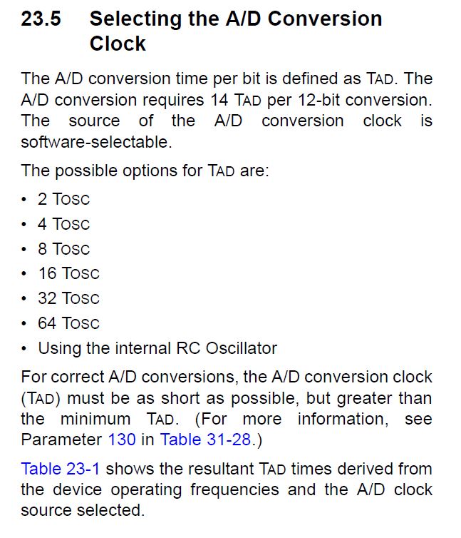

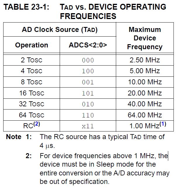

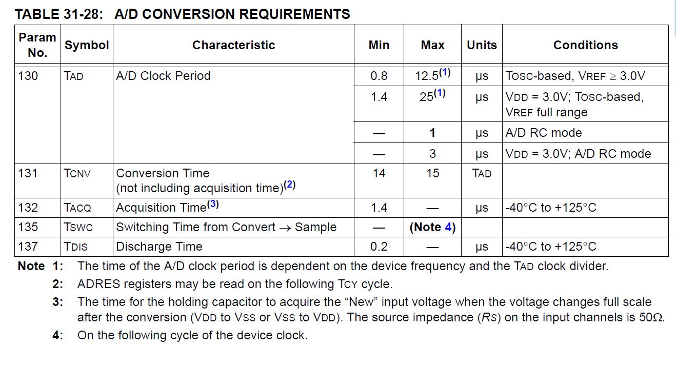

    010=4TAD
    may be too short a time to get full conversion ???
    and especially @ 32 Mhz !!! ( have a look to datasheet ... )

    looking at table 23.1 4 tad should be ok at 32 mhz, using the setting of Fosc/32 for ADCS ???
