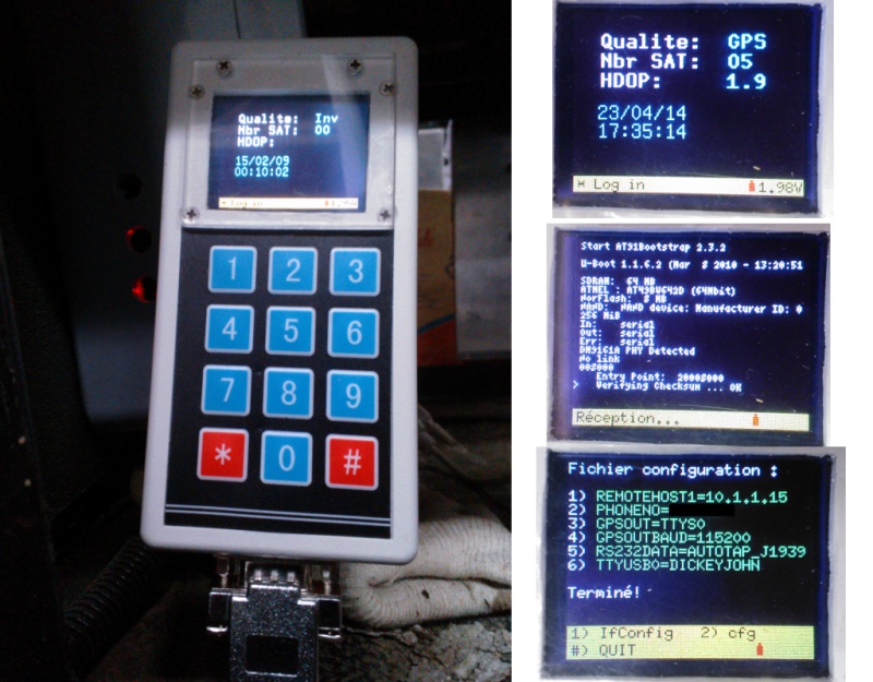

    It's a pre-order deal. I do use these displays because they come with an integrated MCU to process the commands and graph engine. There is an Arduino Demo Code Video on Youtube (see link on the page). Here is an example of what I did with the 160x128 OLED:

    And nice work on the interface, mind sharing some code for other PBP users?

    Henrik: At work I maintain our GPS tracking system. I made this device to diagnose the GPS units but I can't post the code. I'm working on a personnal fun project involving ESP8266+GPS+OLED 160x128. I'll share some code when done... Stay tuned!
